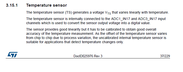

I haven't looked at the CPU temp sensors specifically, but many of ST's peripheral sensors, like MEMs inertial sensors, have chip temp sensors for improving reading accuracy.  What had me going, similar to your question, for a while was the odd temperature readings.  It seems that most of these sensors are explicitly accurate for temperature CHANGES but not for a given reference.  ie; 22 degrees C might return a value of 5.  If this is the case, when the chip warms to 30 degrees, the sensor will read 13 (5 + 8) for an accurate change in temperature, but it does not tell you what either values are referenced to an absolute temperature value.  If this is the case in the CPU temperature sensors, a reading of 10 degrees at room temperature makes perfect sense.  The only question is if you heat it up, does it track changes in temperature?  If so it is up to you to calibrate the zero point.  And rest assured that these change from chip to chip.
Posted on December 11, 2016 at 02:24
Just to add to my above post, the L476 data sheet says exactly what I was describing, but it can be misread if you expect something different:
Note that the data sheet indicates that the temperature sensor is ''suitable for applications that detect temperature changes only''.  It then becomes confusing because on the next page it shows that the part is factory calibrated by testing at 30 degrees C and 110 degrees C.  This might lead you to expect that these data points would yeild accurate absolute temperature measurements.  However I think they only sample two points like that to trim linearity, so that you get an accurate difference in degrees.  But they are referenced to absolutely nothing.
Posted on December 11, 2016 at 03:23
Hi Aaron,
Use of 2 calibration points is actually very standard for linear temperature sensors, and by ST providing them for an inexpensive sensor in a processor like this is I believe somewhat unique. The first portion of the data sheet you reference seems like it was written prior to the 2 calibration points being available. If you have read lots of ST documents and code you will notice they reuse a lot, and this was possibly a cut and paste from some other STM32 chip datasheet. For the latest you should refer to the temperature sensor section in RM0351 (p489) as well as table 8 temperature sensor calibration values in the datasheet.
I did do some basic testing on this, trying the range of CPU frequencies, ADC clock prescalers, sampling cycles and oversampling ratios to see how accurate the chip spec including sampling delay and temperature accuracies were, and I would say that with the 2 point calibrations they are indeed about +/- 1C. When I ran at higher speeds and faster sampling rates I was able to measure actual changes in the chip temperature, and verified these with a temperature probe. And when reducing the speed I could see the temperature reduce back to ambient and stabilizing at room temperature as expected.
I also don't understand how they are able to provide individual chip calibration points, it is possible that they do this by batch and factor in statistics, but they do seem to do the trick. And having them in the chip makes things easy.
I wouldn't necessarily rely on the absolute accuracy for a space mission, but to get a pretty good sense of CPU overheating, or possibly ambient/local temperature, it is quite good. And with calibrations, these are indeed absolute temperatures, not just relative temperatures.
