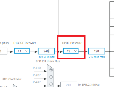

this is the first time i handle with STM32H7 series. in my project control ILI9488 by TouchGFX platform, 4 mosfets, 1 Led. in the first step, i try to blink a led at pin PB5 but seem unsuccess. i don't know how to fix, so can you share me my mistake and how to fix it. in attach file have schematic. can you take a look and share me your input.
SofLit
Getting back to you regarding CubeMx. There is an issue in CubeMx V6.12.1.
For System clock @240MHz/VOS2, the HPRE prescaler needs to be  2.
So in your ioc file set HPRE to 2 instead of 1.
The issue seems to be fixed in an internal version that will be available soon on st.com.
If this solved your issue/answered your question, please accept it as solution.
Thank you.
PS: This is NOT an online support (https://ols.st.com) but a collaborative space. So please be polite in your reply. Otherwise, it will be reported as inappropriate and you will be permanently blacklisted from my help/support.
