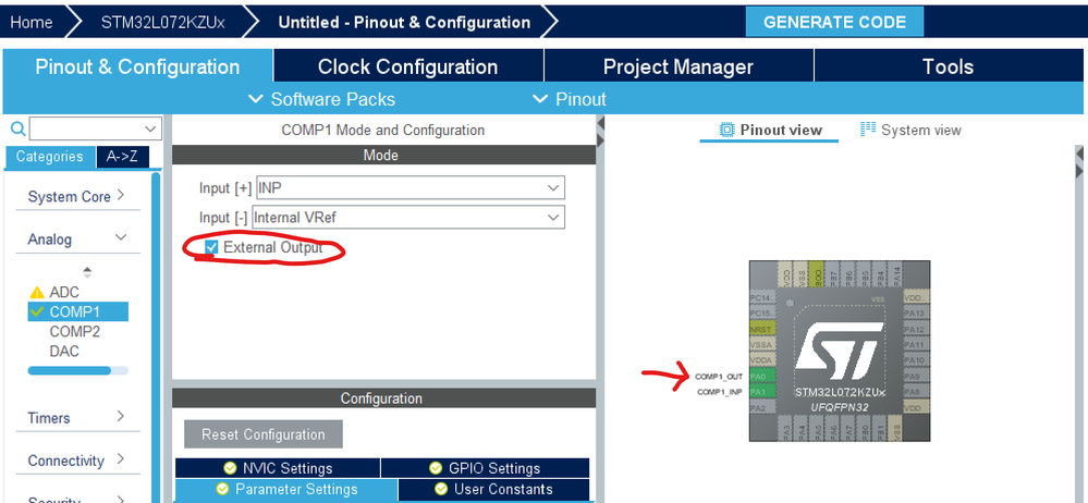

I am working on microcontroller STM32L072KZ and STM32CubeMX.
I am trying to set a value of one pin depending on comparator value. I do not know how to do it in STM32CubeMX.
I want to do it using only hardware, not software.
Can anyone help me?
enable external output?
3 REPLIES 3
waclawek.jan

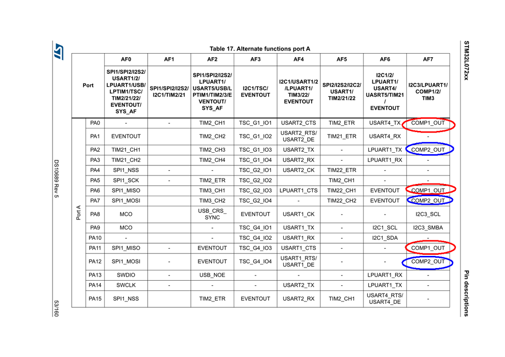

Set the respective pin to AF in GPIO_MODER, and select the proper AF number in GPIO_AFR.
TWaks.1
Thank you, I can't believe it was that easy.
