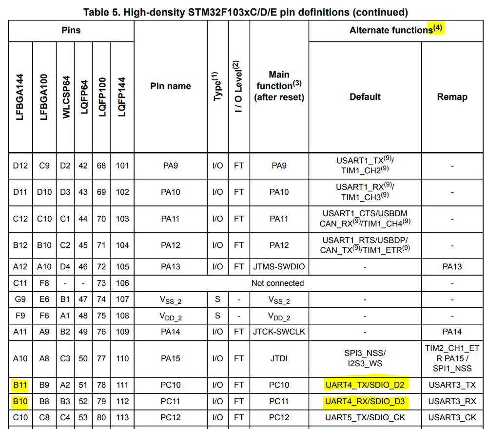

I want to use uart4_tx and sdio at the same time.
But, in cubemx(6.2.1),
SDIO->Mode: SD 1 bit
UART4->Mode: only Disable.

If pins are shared between peripherals, and there are no alternatives, you cannot use them at the same time. Larger chips typically have more options.

STM32F103RCT6 LQFP64.

The STM32F1 family assigns pins on a per-peripheral basis rather than per-pin. Less ancient families do this on a per pin basis. So even though you aren't using SDIO_D2, it shares its functionality with UART4 and you can only have one enabled per the datasheet.
