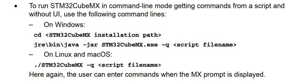

> the docs say you can do this via a script using ./STM32CubeMX -s yourscript.
Clicking the "Help" menu in CubeMX launches UM1718, which tells me that to run in command-line mode using a script​, without UI, you should use
./STM32CubeMX -q yourscript
(with -q not -s). I tested it on linux, and it works.

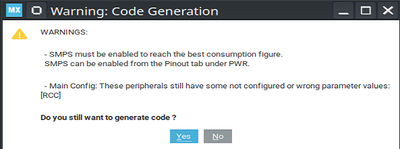

> when running it on the local machine I see a small gui progress bar, and then a dialogue box pops up asking if I'm sure > I want to generate the project.
Inside X, I also get a progress bar, but no dialog or prompt requiring interaction (maybe it depends on your script or project state?). But with Xvfb there's of course nothing and it still works. I was able to generate a project from a ioc with a script (in the virtual console, using xvfb). I also tested that user modifications are preserved.

UM1718 (March 2024) section 3.3.2 "Running STM32CubeMX in command-line mode" states:
To run STM32CubeMX in interactive command-line mode, use the following command lines:
On Linux:
cd <STM32CubeMX installation path>
./STM32CubeMX –i
To run STM32CubeMX in command-line mode, getting commands from a script, use the following command lines:
On Linux and macOS:
./STM32CubeMX –s <script filename>
I do now see the instructions saying to use -q for getting commands from a script without UI, so I guess the docs are at least partially correct.

The dialogue box I get is a warning about incomplete peripheral configuration:
Which admittedly is something that might go away once I've finished setting up my project, although I've spent some time looking for these issues and haven't solved them yet. So maybe it's a non-issue, but it doesn't fill me with confidence that my script could just block waiting for confirmation if something changes.
exactly. If you get these errors while generating from the GUI, you can't expect them to disappear simply because you're generating in headless mode.

@BarryWhit wrote:exactly. If you get these errors while generating from the GUI, you can't expect them to disappear simply because you're generating in headless mode.
I can't expect the warnings to go away, I definitely could expect them to get printed out over the console, as warnings and not block the generation process.
