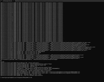

Hello @dvescovi
In your script , just do the following modification :
config load <filename>
generate code <path>
exit_mx
Example
config load "C:\Users\gsourigh\OneDrive - STMicroelectronics\Desktop\Thread\testcodegen\DCC_tester.ioc"
generate code "C:\Users\gsourigh\OneDrive - STMicroelectronics\Desktop\Thread\testcodegen"
exit_mx
Then launch the following command after cd the installation path of MX6.16.0
jre\bin\java -jar .\STM32CubeMX.exe -q "script path"
example
jre\bin\java -jar .\STM32CubeMX.exe -q "C:\Users\gsourigh\OneDrive - STMicroelectronics\Desktop\Thread\testcodegen\generatecode.txt"
As you can see , the code will be generated successfully.

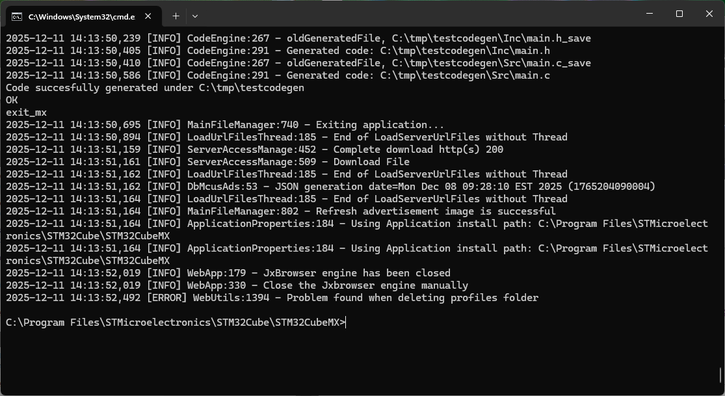

looks like you have cubemx installed in a different location. I have mine at:
C:\Program Files\STMicroelectronics\STM32Cube\STM32CubeMX\STM32CubeMX.exe
which is Windows standard location for everyone.

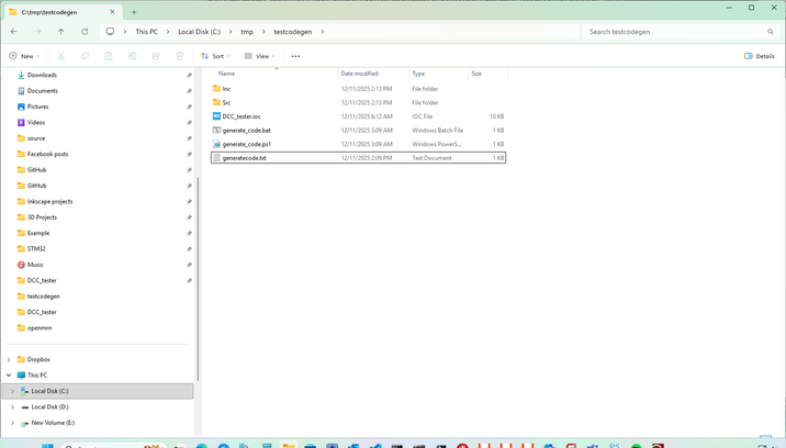

I have ioc and script in my c:/tmp/testcodegen
generatecode.txt now looks like:
config load C:\tmp\testcodegen\DCC_tester.ioc
generate code C:\tmp\testcodegen
exit_mx
launched by cd to
C:\Program Files\STMicroelectronics\STM32Cube\STM32CubeMX>
then
C:\Program Files\STMicroelectronics\STM32Cube\STM32CubeMX>jre\bin\java -jar .\STM32CubeMX.exe -q "C:\tmp\testcodegen\generatecode.txt"

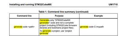

Tried again using my correct full paths and I get some source code generated but not cmake, linker startup etc.
you can src and inc folders and files created within but NO cmake, linker, or start up files.
did not have quotes around path in generatecode.txt but even after adding them ... same results.
Hello @dvescovi
In your script , let's try to use "project generate" instead of "generate code"

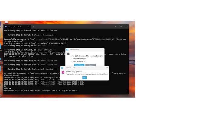

Yes, that is much better. Looks like everything is being generated.
Does not seem to exit gracefully though.
Attached is revised Cube32MX and PowerShell script.
Hello @dvescovi
Just use "exit" instead of "exit_mx"
