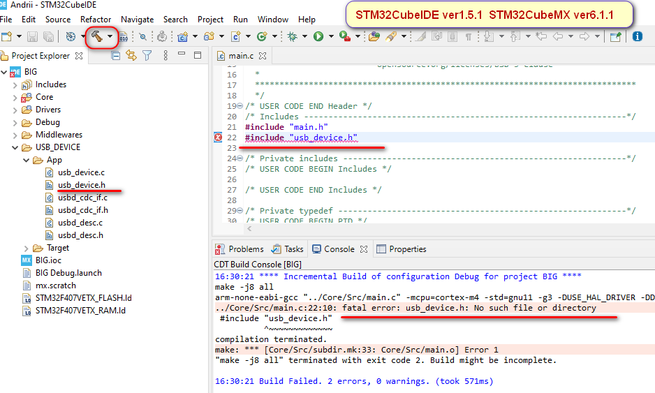

Problem with new version STM32CubeIDE ver1.5.1 and STM32CubeMX ver6.1.1 (fatal error: usb_device.h: No such file or directory)
Before that there was STM32CubeIDE ver1.4.0 STM32CubeMX ver6.0.0 everything was fine.
Installed STM32CubeIDE ver1.5.1 and STM32CubeMX ver6.1.1, there was an error when connecting USB_DEVICE.
Tried creating a project from scratch with nothing but USB_DEVICE. Gives an error message.
What to do?

Added everything. It didn't get any easier. Error again!
0693W000007BXRjQAO.pngI specifically looked at the settings on the old version. The settings on both the old and the new version are the same. But the new one doesn't work!

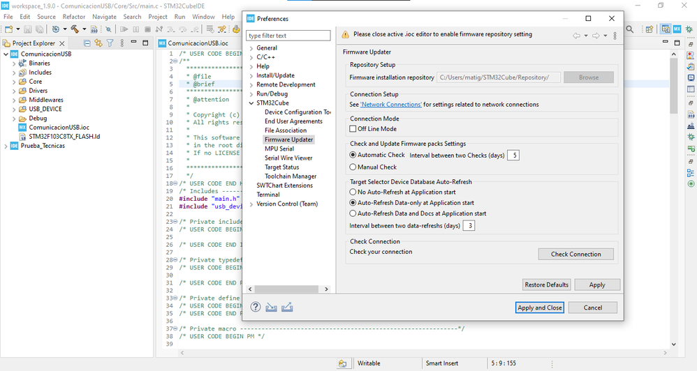

I had the same problem with CubeIDE 1.9.0. I was looking for the solution for several hours until I saw the suggestion of @IPaku.1​ and finally I could solve the problem. In order to solve it I did the following:

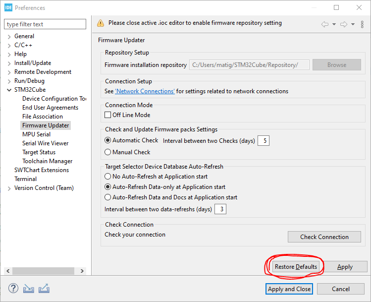

Inside the CubeIDE I went to "Window -> Preferences -> STM32Cube -> Firmware Updater"
0693W00000QKl9YQAT.pngIf you have the same problem, it is probably because at some point you changed the address of "Firmware installation repository". I say this because when I had done that, the problem started.
The solution was click on "Restore Defaults" then "Apply and Close" and finally create a new project.
0693W00000QKlBjQAL.pngI hope you can solve it too. Good luck!
