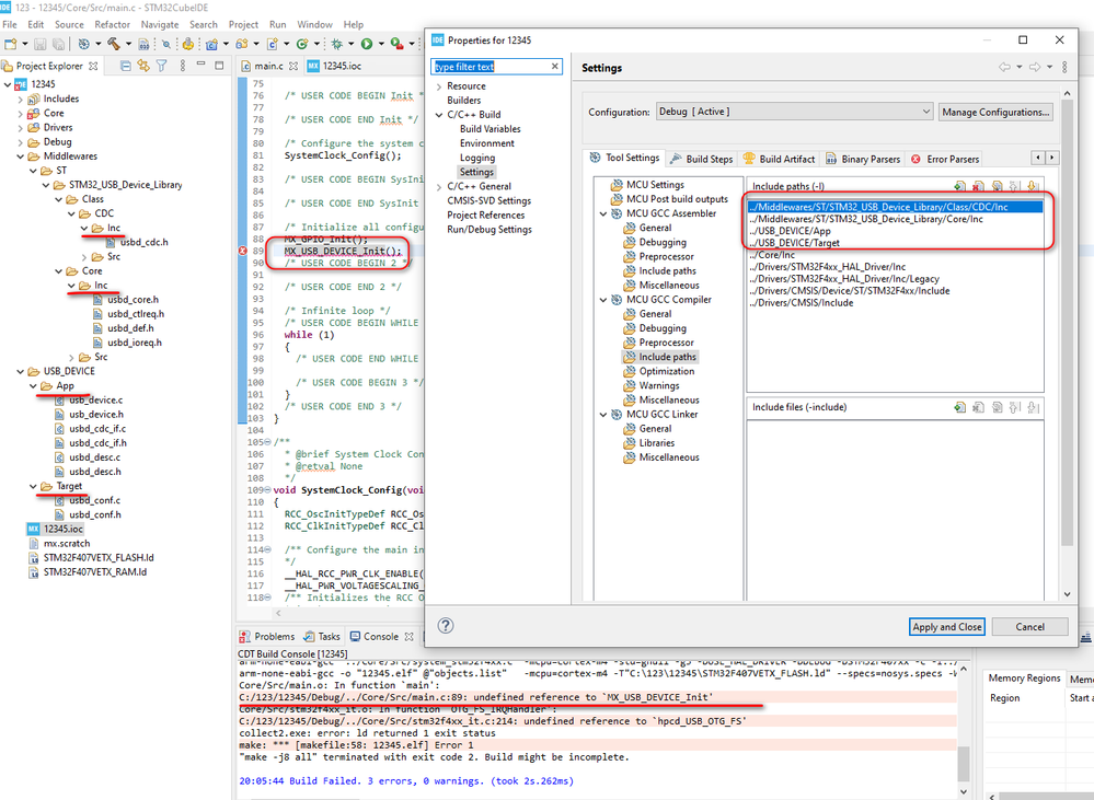

Problem with new version STM32CubeIDE ver1.5.1 and STM32CubeMX ver6.1.1 (fatal error: usb_device.h: No such file or directory)
Before that there was STM32CubeIDE ver1.4.0 STM32CubeMX ver6.0.0 everything was fine.
Installed STM32CubeIDE ver1.5.1 and STM32CubeMX ver6.1.1, there was an error when connecting USB_DEVICE.
Tried creating a project from scratch with nothing but USB_DEVICE. Gives an error message.
What to do?

Check your include directories
Project properties -> C/C++ Build -> Setting -> Tool Settings -> MCU GCC Compiler -> Include Paths

Added everything. It didn't get any easier. Error again!

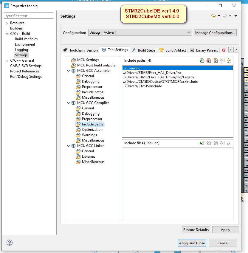

0693W000007BXRjQAO.pngI specifically looked at the settings on the old version. The settings on both the old and the new version are the same. But the new one doesn't work!
Jan 16, 2021 4:26 PM UTC
Different error message. It sees the file now. The init function should be within main.c. Regenerate the code. If that doesn’t work, attach your IOC file.

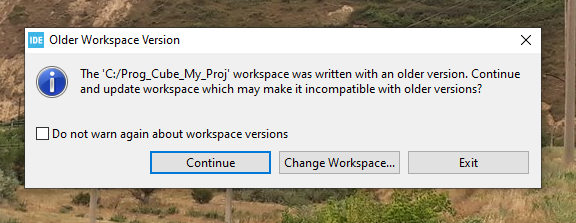

1) I'm launching a new version of STM32CubeIDE ver1.5.1 (STM32CubeMX ver6.1.1).
I indicate the directory with the old project on STM32CubeIDE ver1.4.0 STM32CubeMX ver6.0.0.
At startup it says: “The workspace was written with an older version. Continue and update workspace which may make it incompatible with older version? ".
0693W000007BXbyQAG.pngI click Continue.

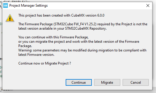

An older version message appears.
0693W000007BXc8QAG.pngI click Continue.
The project opens and works as expected.
Settings in the photo.

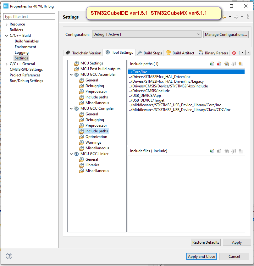

0693W000007BXcDQAW.png2) I click to create a new project.
I indicate the same chip.
USB only settings in virtual com port mode.
I generate a project.
Checking - again the same error!
