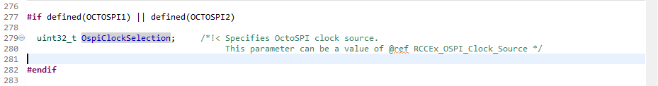

​Hi @CesarH​
After check, according to the AN5050 OCTOSPI application PDF, the location of the following code is correct, it should be initalized in the main function :
sMemMappedCfg.TimeOutActivation = HAL_OSPI_TIMEOUT_COUNTER_DISABLE;
sMemMappedCfg.TimeOutPeriod = 1;
if (HAL_OSPI_MemoryMapped(&hospi2, &sMemMappedCfg) != HAL_OK)
Error_Handler();
For the RCC clock and after check, the definition of RCC as clock exists in the stm32l4xx_hal_rcc_ex.h file as shown in the following photo:
Regards,
Nesrine
