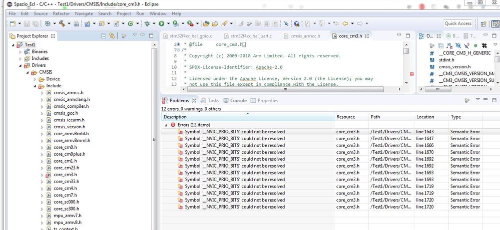

NVIC PRIO BITS could not be resolved - [Solved]
AMoro.4
Hi to everybody, I am a total mcu beginner and I cannot compile a project. I did not write a single line of code, just tried to build. When I tried to do it I had 12 identical errors.0690X000008wTJnQAM.jpgWhat can I do? I have a STM32 F446RE Nucleo 64 board, Cube MX 5.1.0 and OpenSTM32 System Workbench 2.9.

​Hello @AMoro.4​ ,
Could you please share your ioc file?
Best Regards,
Khouloud.
Hi Khouloud,
thank you for the reply. Here is the file

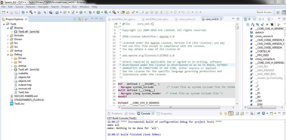

AMoro.4
Now it compiled, but gave me just the .elf file, while I am looking for the .bin file too.0690X000008a6v2QAA.jpg
Khouloud ZEMMELI
for the first request : issue can't be reproduced -> project compiled with no problem (and it was your case right now) , for the second one :​There's only .elf  and .hex file.
