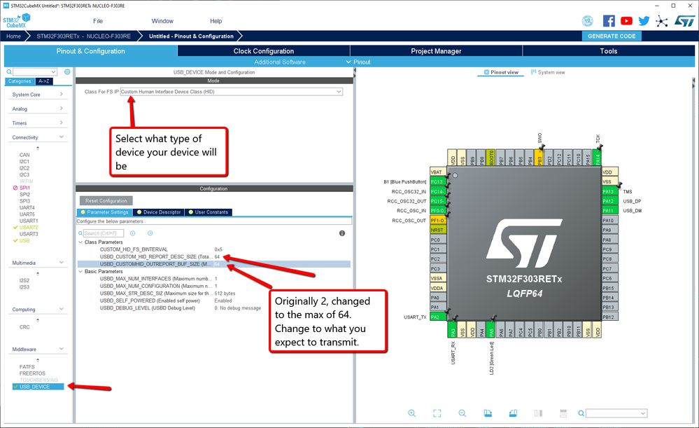

So I am using Nucleo64 (303RE) board for USB HID mouse project.
As you know, it does not have second USB port for USB applications but it does have PINS that can act as DM, DP (USB minus, plus data).
When I configured everything, I run debug and it was telling me that packet has been send successfully, but I could not see any signal on oscilloscope. NOTE that I checked clock output for USB and it was a good looking 48MHz clock.
Can anybody tell me what am I doing wrong ? Maybe its necessary that board has another USB port and these GPIO pins cannnot be directly used in that way. To be honest I am frustrated and this thread is my last hope.

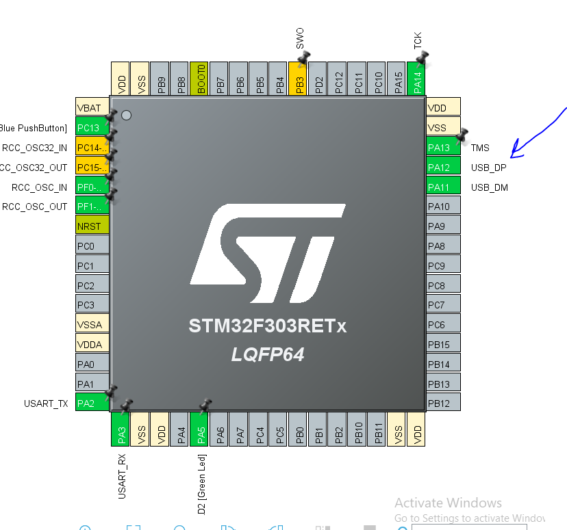

With a nucleo-F401RE, I was able to just create a tiny USB cable that plugged into the female headers on the board, for my cable I used:
PA9 - VBUS
PA11 - USB DM
PA12 - UBS DP
And of course a ground connection.
It was pretty crude but it served its purpose.
I used VBUS on my 401 but looking at the 303 it doesn't look like that is available.

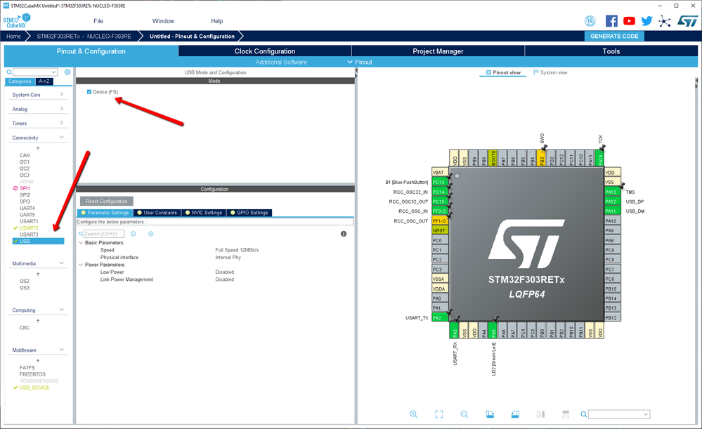

If you are using STM32CubeMX (which I would suggest), did you enable the various USB elements? Take a look at the images. 0690X00000BvkQmQAJ.png0690X00000BvkQXQAZ.png
I created a project in the latest version of STM32CubeMX and attached it. I don't have a F303 to test with so you will have to give it a try.

Even though I think I enabled every USB component (enabling FS and HID from CubeMX, then externing USB struct and including appropriate library files.) I will definitely have close look at your recommendations.
