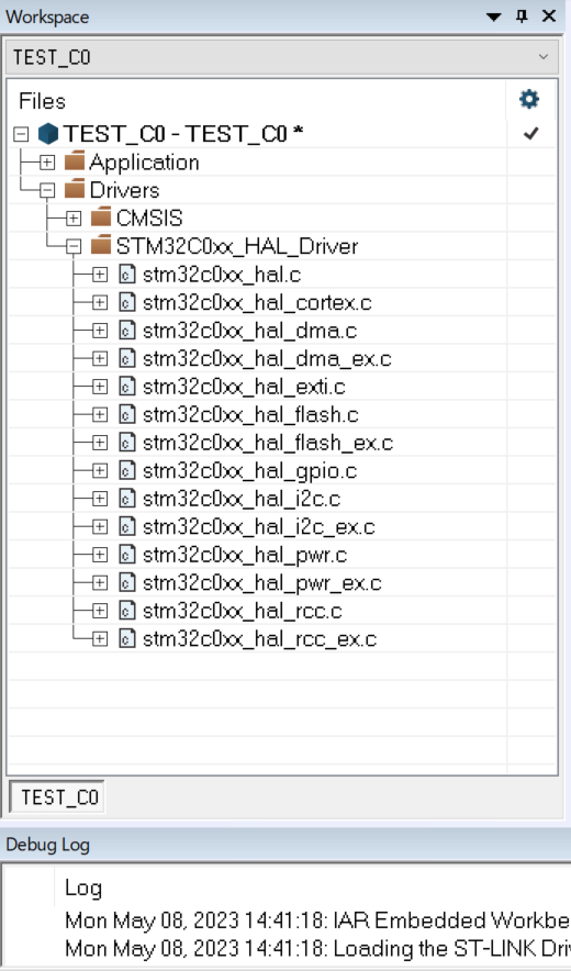

I've already configure the I2C and generate the code
_legacyfs_online_stmicro_images_0693W00000bjbZGQAY.pngAfter that I re-configure by removing I2C and I've good results :

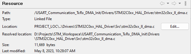

In your CubeIDE project view, the HAL file are shortcuts.
Have you selected in CubeMX "Add files... as reference", or was the option different and you changed it to "copy..." later? What is the resolved location of missing HAL files?

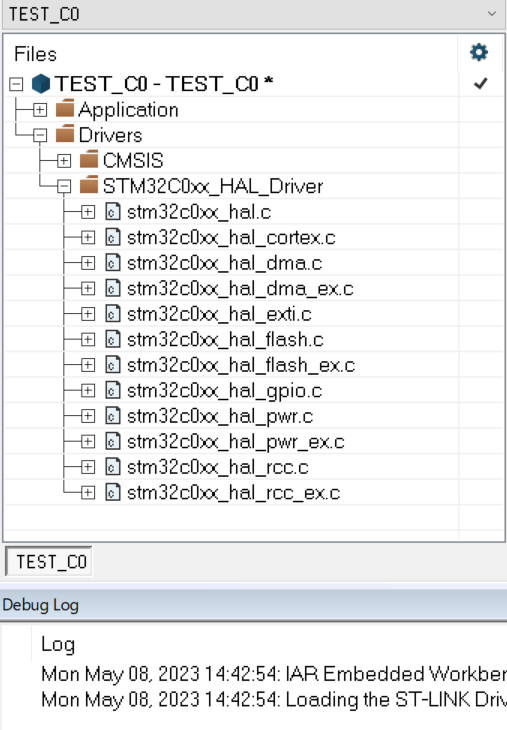

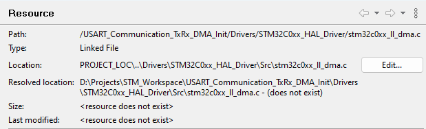

_legacyfs_online_stmicro_images_0693W00000bjev5QAA.pngOpend the "USART_Communication_TxRx_DMA_Init.ioc", changed the Parity to Even and then back to None and saved, when asked to generate code responded "Yes".
As soon as the project is reconfigured the driver files are deleted. Confirmed by checking the directory "D:\Projects\STM_Workspace\USART_Communication_TxRx_DMA_Init\Drivers\STM32C0xx_HAL_Driver\Src\", both the Src and Inc files have been deleted.

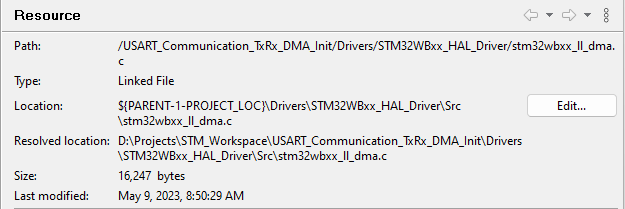

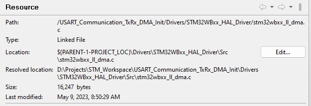

To confirm I loaded the same example for the P-NUCLEO-WB55-NUCLEO eval and it works as expected. So I can only assume there is an issue with the C031 implementation.
