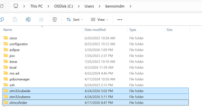

Hello @BrucePB
I reproduced the test and the STM32CubeIDE update was successful.
I recommend that you delete the cache folders [.stm32cubeide, .stm32cubemx, .stm32cubefinder] under this path:
C:\Users\, set the network connection and relaunch the update process.
Thanks.

Hi Mahmound,
    I did not find those folders.  I am using Windows 10 and ST says they no longer support that OS because MS no longer support it.
Bruce
Hello @BrucePB
The Supported operating systems and architectures
• Windows® 10 and 11, 64 bits (x64)
• Linux®: Ubuntu® LTS 22.04 and LTS 24.04, and Fedora® 43
• macOS® 15 (Sequoia), macOS® 26 (Tahoe)
You find the cache folders under C:\Users\
Thanks.
