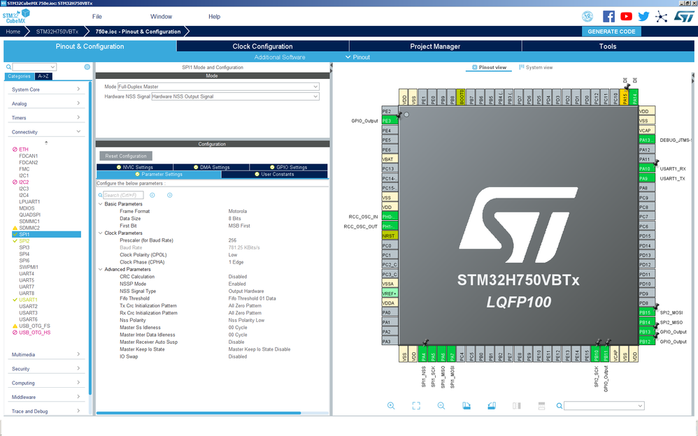

I don't need NSS signal or pin, I would rather use it as a real Chip select. But it looks like it there is no SPI at all without NSS? What should I change? CPU is STM32H750.

You're changing the wrong thing. Change the "Hardware NSS Signal" pulldown at the top of the page.
Correct. Turning the hardware NSS off allows the processor software to control the NSS signal. In fact, you need this behavior when concatenating two transmissions, one with a command, one with data. For writing to some displays, you must hold down CS, sent a command with a separate A0 line low (IIRC), then send the data with the A0 line high. Trying to do this with hardware NSS does not keep the CS to the chip active, but instead, controls it separately for each transmission, which doesn't work.
Hardware NSS works for simple chip interfaces where you can either send commands and data as one unit, (preferably with a known size), or don't have an extra register/data select line (and can concatenate the command and data).

Thank you both.

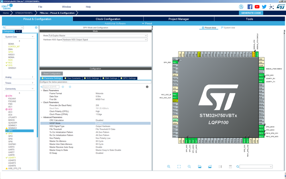

You are sure that this "Change the "Hardware NSS Signal" pulldown at the top of the page." alone is enough? I thought that I have tried that too and many other combinations.
Currently I have a single SPI slave, MAX31865 a PT100 chip, on the bus and I am handling the chip select with a GPIO pin. What I have read the NSS signal tells that it isn't very helpful.
Yes, set it to disabled and just go try it. If it doesn't work, post a screenshot.

I got it working, at least I see clock and MOSI. I have some work to do yet, but got forward. Thank you.
