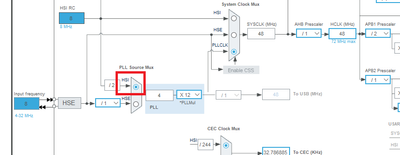

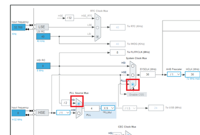

‎2024-09-15 10:11 AM
Hello @John_S and welcome to the community,
According to your Clock config and the screenshot you shared, you are using the internal clock HSI as clock source for the system not HSE (for external crystal usage):
And from your code:
RCC_OscInitStruct.OscillatorType = RCC_OSCILLATORTYPE_HSI;
RCC_OscInitStruct.PLL.PLLSource = RCC_PLLSOURCE_HSI;
RCC_OscInitStruct.PLL.PLLMUL = RCC_PLL_MUL9;
That's strange!

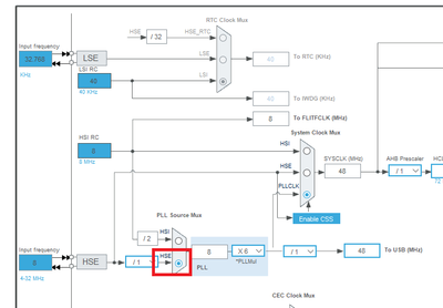

‎2024-09-16 8:09 AM - edited ‎2024-09-16 8:16 AM
config file ..
plus
Main.c
I was going to upload the whole project but wont accept .zip ...
Project made fresh in STM32cubeMX then loaded in to cubeIDE ..
as a test i shut down IDE .. pulled the ST/link out so no power . Put plug back in (nothing ) , reloaded IDE up loaded with debug the file that was just working ... nothing ..... i'm a bit confused

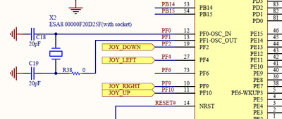

‎2024-09-16 8:30 AM - edited ‎2024-09-16 8:32 AM
That config is different from what you posted in the first post:
The first one is using HSI and now it is using HSE. Please try to not induce us to confusions during the discussions.
Are you sure X2 crystal is mounted on its socket? Is R38 soldered?
‎2024-09-16 8:37 AM - edited ‎2024-09-16 8:38 AM
sorry i've been trying different configurations to see what works... I may have got mixed up between the two.
Yes crystal is in and r38 is in (0 ohm )

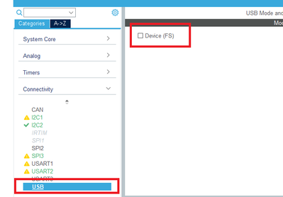

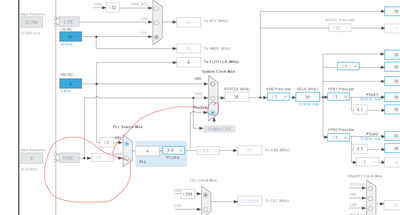

‎2024-09-16 8:43 AM
And if you revert o the first config: HSI (remove USB function for the moment), do you get the same behavior?
‎2024-09-16 8:50 AM - last edited on ‎2024-09-16 8:54 AM by mƎALLEm
The code runs :)

‎2024-09-16 8:54 AM - edited ‎2024-09-16 8:55 AM
First, in next time please use </> button to share your code. I'm editing your post then .
Second, as with HSI is working, I'm pretty sure it's something related to the crystal. Be sure the crystal has contact in the socket. Maybe to apply a bit pressure on it with your finger.
