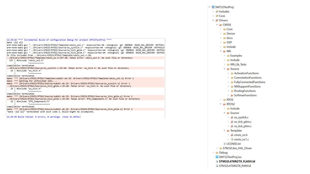

New CubeMX-created project does not build in CubeIDE v2.1.0
Geoff104
Split from STM32CubeIDE version 2.1.0 won't generate IOC project file as this is a new question.
Please keep to one question per thread.
Thanks both Ghofrane GSOURI & Andrew Neil for pointers. Adopting the method shown in the presentation. I have selected a nucleo development board to create an STM32MX project. I have then created a STM32CubeIDE projecfrom the MX project. Having not written any code yet, I'm getting compilation errors but have no idea why? The errors are relating to files marked with a red x below:

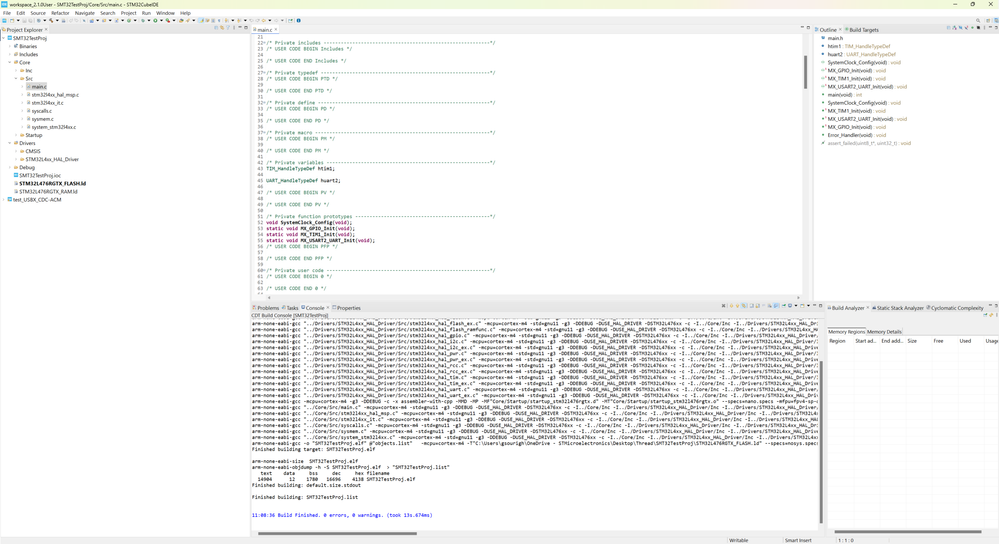

Hello @GChol.1
I have just run a test using your IOC file, and the project builds successfully, as shown in the screenshot below.
Please try the following on your side:
1- Move your IOC file to a new, empty folder.
2- Open this IOC file in STM32CubeMX.
3- Generate the code for your IDE from STM32CubeMX.
5- Open the generated project in the IDE and rebuild it.
THX
Ghofrane

@Ghofrane GSOURI Many thanks, suggestions worked!
