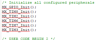

I use Stm32CubeMX v4. It creates the code for TIM2, TIM3 and TIM8 (STM32F103VCT, custom board). All timers have 'Clock Source == Internal Clock' and 4 channels configured to 'Input Capture direct mode'. When I debug the code with sw4stm32 v2.2.1 (ubuntu 04 x64) there is not return from 'Step over' debugging in MX_TIM2_Init(). Debugging hangs. The code is attached.
After that in addition the only way to reload (or erase) the code is to connect the reset pin of St-link v2 to MCU NRST and use 'Reset Mode == Connect under reset'.
When I comment MX_TIM2_Init() debugging is OK with 'Reset Mode == Software system reset'.
Is there a way to debug with TIM2?

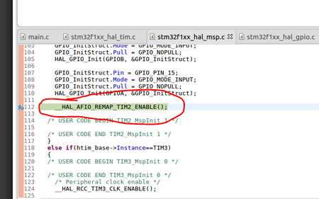

I can not run callgraph in sw4stm32 - 'Unhandled event loop exception
java.lang.StackOverflowError'. I increase 'Minimum stack size' in
stm32cubemx 2 times to 0x800. No effect.
I attached screens for 'Step Into'. Debugging hangs in line 112
stm32f1xx_hal_msp.c __HAL_AFIO_REMAP_TIM2_ENABLE();
Regards,
Boris.

Are you use JTAG ?
__HAL_AFIO_REMAP_TIM2_ENABLE()   remaps CH1 to PA15, CH2 to PB3.  Theese pins used by JTAG also.
In this case is normal to have  ''hang'' . (JTAG can not communicate)

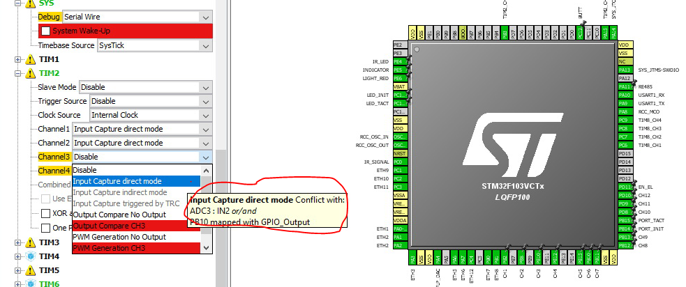

Posted on September 19, 2017 at 16:38
I can't understand how this code generated.
__HAL_AFIO_REMAP_TIM2_ENABLE()  is a full TIM2 Remap (remaped to B11, B10, B3, A15 pins)
But according to your IOC file you can't sellect  PB11, PB10  because are reserved  as GPIO outputs.
I use an updated version of CubeMx 4.22.1
regards
vf
Posted on September 19, 2017 at 16:55
Excuse me,
I have sent a wrong ioc and code. Correct ones are attached.
Regards, Boris.
