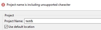

‎2020-08-28 5:32 AM
Hi @NGajic​ ,
I think it's not a bug in CubeMX.
This king of unsupported character is also seen when creating eclipse project for example (see below an eclipse screenshot).
Regards,
Aymen.

‎2020-08-28 5:37 AM
Hi @Aymen CHAKROUN​ ,
Ok, if this character cannot be used in Eclipse (I didn't know that), than you should give some info to the users, because generation is stuck and nobody knows why, progress bar is stopped and nothing happens. You have to use Task Manager to kill the process.
Cheers,
Nenad
