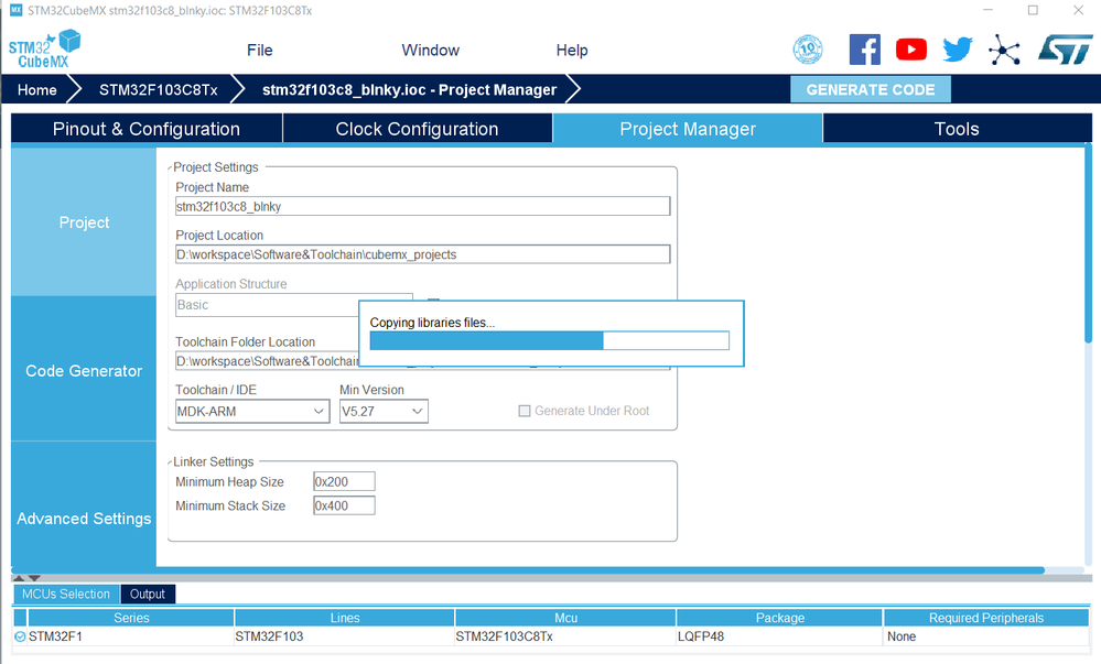

MX 5.4.0 Bug: cubemx stuck at copying library files while Generating code
2019-10-26 11:50 PM
can anyone help me with this problem cubemx is stuck at copying library file while i try to generate code for keil mdk version 5.28 cannot close the window and have to terminate the program using task manager i am using windows 10 system

Hi @Khouloud Zemmeli
I have the same problem too!
It stuck on "copying library files" for hours! What's more, the whole program is stuck either. Neither clicking the close bottom nor ending the "stm32cubemx" progress in the task manager does any help to closing it. The only way to end the Cube is ending the JAVA program.
Since this problem approaches, I have tried every method I can do including reinstall CubeMX , jre , Keil, and HAL libraries, the luck is still not for me.

2019-12-29 2:47 PM
I have almost the same problem, using version 5.4.0
2020-02-06 8:47 PM
Do not put & in the file path.
2020-02-06 9:18 PM
That's it!
I found this problem last night.
Anyway, thank you very much!
