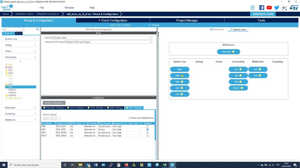

I have understand that in the master (I am using a FPGA) I must select low or high the CS to select the slave (STM32F411VE board), but what about the slave?, do I need to implement something like this to receive the data?

I have this query because I am doing tests (second way) in the slave but always receive data when I connect the CS pin to GND or 3.3V, and in the TransmitReceive function I dont´t find any line of code that checks if CS is enabled or disabled to start the tx/rx of data

Use the SPI_NSS pin configured in input mode - let the H/W do it for you :)
Hi, I have configured the NSS in this way, so you tell me that when the nss is configured by hardware the function detects it automatically?, I thought this was only when I configure nss in software mode (disabled in cubemx)

Certainly seems to work. I'm using SPI in receive simplex mode with interrupts buffering the incoming data into a circular buffer and when I disconnect NSS the receive stops as you would expect.
