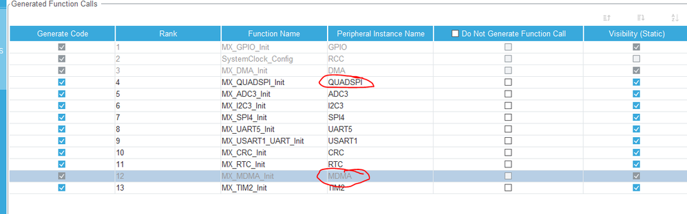

Cube mx is generating this order of init code.
Stm32cube ide 1.9.0
stm32cubeh7 1.10.0
Solved! Go to Solution.

Hello @Community member​,
I am getting back to you regarding this issue. It has been fixed within the STM32CubeMX V6.7.0.
Thank you.
Chahinez.
I have reproduced the issue and reported it the STM32CubeMX team for further check.
Internal ticket number: 130352(This is an internal tracking number and is not accessible or usable by customers).
Thank you.
Chahinez.

@Community member​ also had several post(s) about the Auto-Polling and the Timeout behaviour.
Basically that it would just keep on clocking. I don't think the exit path for the TIMEOUT is clean, and it looks to need to have the bus operation aborted, and none of the examples do any of that, and seem oblivious to it, leading to what I assume will be cascading failure.
Please review, and ticket as appropriate.
Thanks, -Clive
