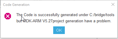

Using the latest version 5.5 of stm32cubemx. When I try and generate a new project I get the following error after clicking generate code
The resulting project file is unusable.
I've attached the ioc file for this project.
I'm presuming this is a bug that has to be fixed by the cube team, but if someone could come up with a workaround in the meantime ;)
Cheers
Glen.

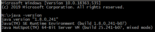

Problem appears with java 13 version, could you please switch to an other java version (8 for expl)?

‎2020-01-23 6:51 AM
Hi Khouloud,
Thanks for the reply.
I do have java 8 installed, not java 13, and the problem is still there.
Anything I can do to get it working until the next release?

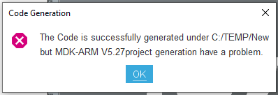

‎2020-03-19 2:26 AM
The folder names are simple. The problem remains.
Keil version 5.29.0.0
CubeMX 5.6.0
