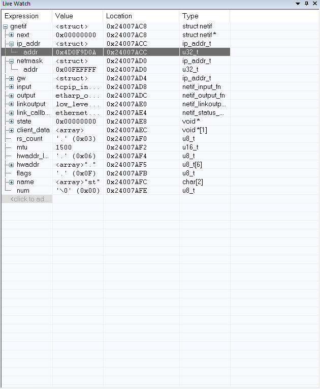

After I generate the code, I add an extern variable to my main.c to be able to track whether the device has obtained an IP address:
/* USER CODE BEGIN PV */
extern struct netif gnetif;
/* USER CODE END PV */
Moreover, I add the standard LwIP/RAW IP callbacks t the main loop:
/* Infinite loop */
 /* USER CODE BEGIN WHILE */
 while (1)
 /* USER CODE END WHILE */
 /* USER CODE BEGIN 3 */
 ethernetif_input(&gnetif);
 sys_check_timeouts();
 /* USER CODE END 3 */
This code works well and I am able to get an IP address (I can determine it frome the gnetif->ip_addr field), I can see all the proper ARP request in WireShark and I am able to ping the device:

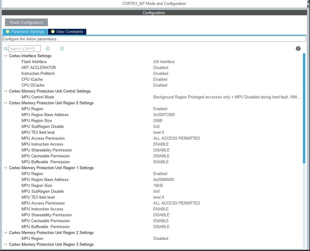

Hi @KR​
I apologize for the delay and I have the honor to inform you that I finally had a solution to run the LWIP on H7
1- You must activate the MPU control mode in Background Region Access Not Allowed + MPU Disabled during hard fault, NMI and FAULTMASK handlers
2- You must configure the region 0 and 1 according to the configuration found in the code
You will find a screen print for the simulation and generate code
I will remain at your disposal for any other questions.
Hi @RMuel.18.303​
I will remain at your disposal for any other questions.0690X000006Dt51QAC.png

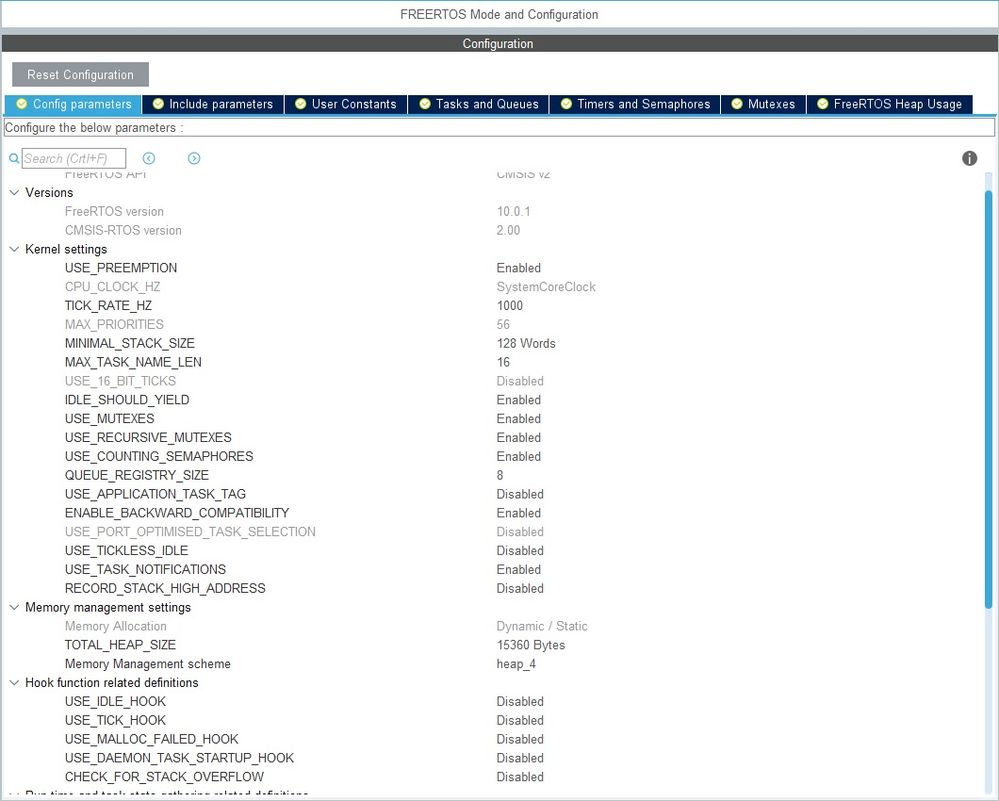

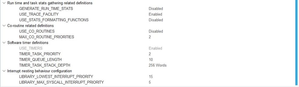

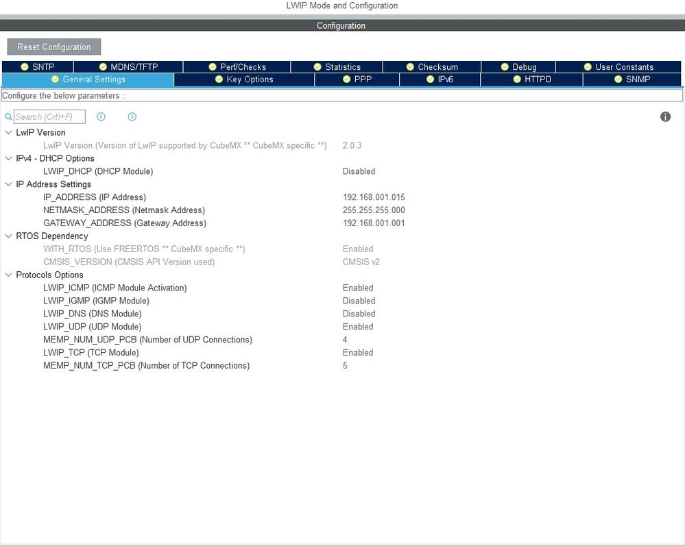

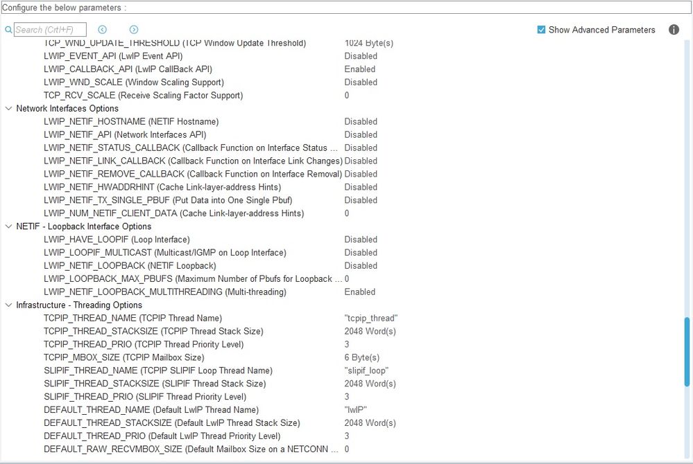

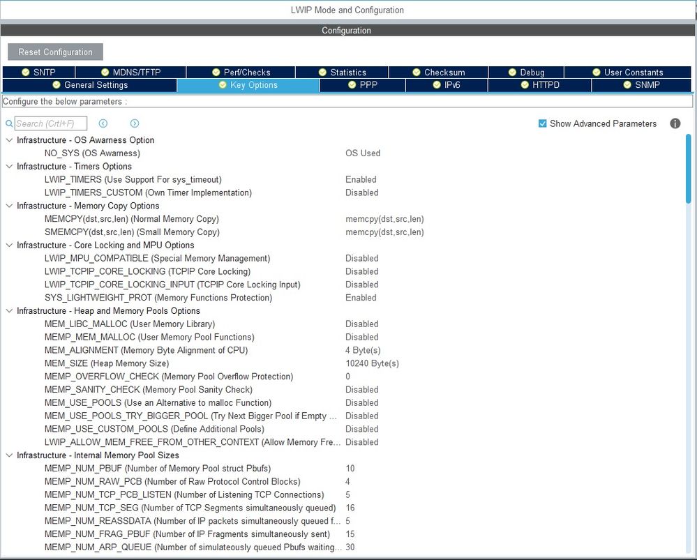

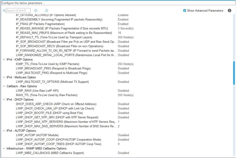

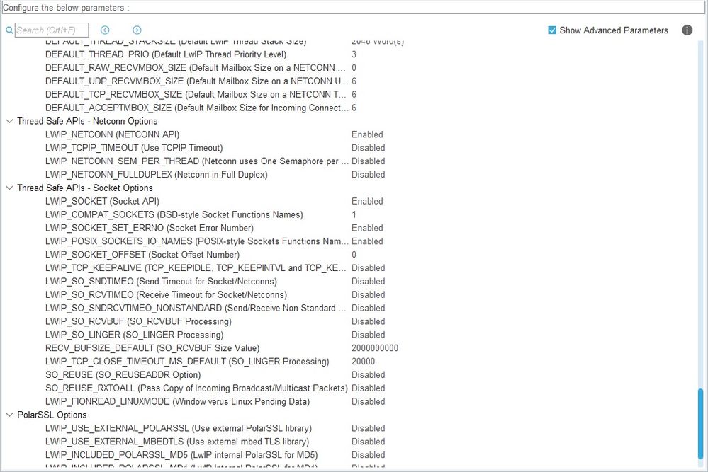

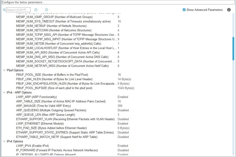

KFili
Hi everybody and @WBOUG​
I tried to use LwIP_HTTP_Server_Netconn_RTOS example on STM32CubeIDE. (STM32F767ZI-NUCLEO BOARD) but it could not run properly.
it works for 2 mins then stucks. (Sometimes it effects the other tasks sometimes it doesn't)
I share all configurations' screenshots.
I would be grateful if you show me where I have the mistake.
void StartDefaultTask(void *argument)
  /* init code for LWIP */
  MX_LWIP_Init();
  /* USER CODE BEGIN 5 */
  http_server_netconn_init();
  /* Infinite loop */
  for(;;)
	  osThreadTerminate(NULL);
	  osDelay(1);
  /* USER CODE END 5 */
/* MPU Configuration */
void MPU_Config(void)
  MPU_Region_InitTypeDef MPU_InitStruct = {0};
  /* Disables the MPU */
  HAL_MPU_Disable();
  /** Initializes and configures the Region and the memory to be protected
  MPU_InitStruct.Enable = MPU_REGION_ENABLE;
  MPU_InitStruct.Number = MPU_REGION_NUMBER0;
  MPU_InitStruct.BaseAddress = 0x2007C000;
  MPU_InitStruct.Size = MPU_REGION_SIZE_256B;
  MPU_InitStruct.SubRegionDisable = 0x0;
  MPU_InitStruct.TypeExtField = MPU_TEX_LEVEL0;
  MPU_InitStruct.AccessPermission = MPU_REGION_FULL_ACCESS;
  MPU_InitStruct.DisableExec = MPU_INSTRUCTION_ACCESS_ENABLE;
  MPU_InitStruct.IsShareable = MPU_ACCESS_NOT_SHAREABLE;
  MPU_InitStruct.IsCacheable = MPU_ACCESS_NOT_CACHEABLE;
  MPU_InitStruct.IsBufferable = MPU_ACCESS_BUFFERABLE;
  HAL_MPU_ConfigRegion(&MPU_InitStruct);
  MPU_InitStruct.Number = MPU_REGION_NUMBER1;
  MPU_InitStruct.BaseAddress = 0x20080000;
  MPU_InitStruct.Size = MPU_REGION_SIZE_16KB;
  MPU_InitStruct.IsCacheable = MPU_ACCESS_CACHEABLE;
  MPU_InitStruct.IsBufferable = MPU_ACCESS_NOT_BUFFERABLE;
  /* Enables the MPU */
  HAL_MPU_Enable(MPU_PRIVILEGED_DEFAULT);
0690X00000Bud2qQAB.jpg0690X00000Bud2vQAB.jpg0690X00000Bud30QAB.jpg0690X00000Bud3AQAR.jpg0690X00000Bud3FQAR.jpg0690X00000Bud3KQAR.jpg0690X00000Bud3PQAR.jpg
