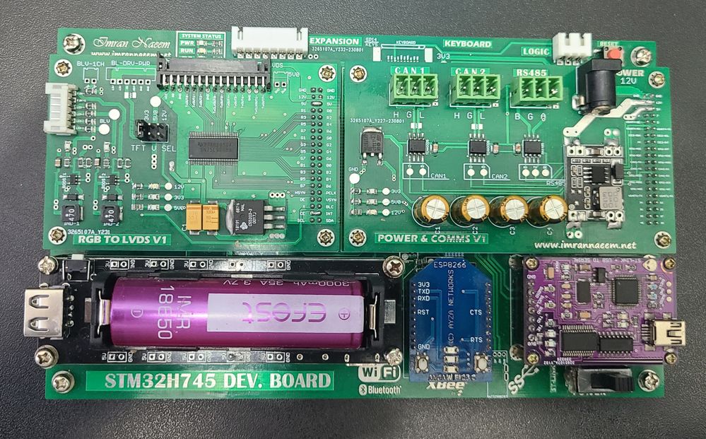

Here is TouchGFX running on Samsung Tab3 10.1" 1280x800 TFT. (STM32H745)
Here is TouchGFX running on Samsung Tab3 7" 1024x600 TFT. (STM32H745)
My custom designed board is similar as below.
If you need some guidance then don't hesitate.
