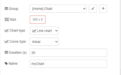

I'm aware that the chart can be resized with the 'Size' parameter.

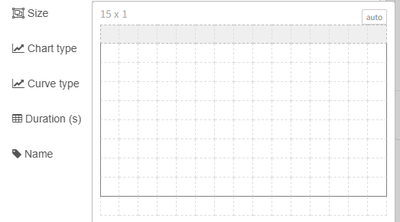

However, attempting to expand it beyond size 15 horizontally just shuts the window down:
(Furthest I can go horizontally)
While it is possible to expand it out vertically to an arbitrary size.
Jut wondering if this is a bug or horizontal size 15 is the max limit for the chart.
on 4k Monitor the chart size of 15x9 is way too small.

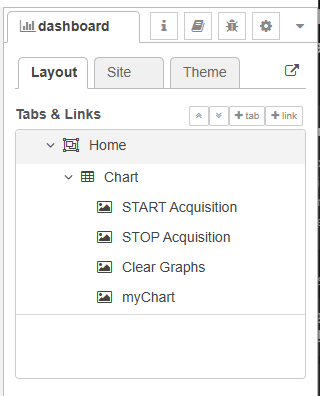

Chart size parameter is limited by the dashboard layout Width. to modify it:
On the right side of the flow editor click on dashboard icon
In the Layout panel, move your mouse on the tab you want to expand, click on Layout
You'll get access to the Width parameter
To give better visibility on the answered topics, please click on Accept as Solution on the reply which solved your issue or answered your question.

- clicking once on the 'size' menu gives me this table-generator lookalike grid,
on which when i try to go any further than 15 in terms of horizontal size just closes on me:
- double clicking on n x m chart size gives me this configuration window:
on which no matter what i put in for the horizontal size (tried 16, 30, 300...),
the chart I get when I deploy the dashboard seems to have a fixed horizontal size of 15.

You need to move your mouse on the home "line" to get the layout button available
Width changed to 30 on Dashboard Layout Editor : Home like below:
If I deploy and pull out the dashboard, the horizontal size of the chart is still the same,
regardless of the 'width' parameter i put in for the chart.
Any possible way to actually horizontally expand out the chart so it fills up the dashboard?
Richard.Chvr
Sounds strange,
Did you also change chart size after changing Width to 30?
You can set it size to "auto" in order it fits the dashboard width
