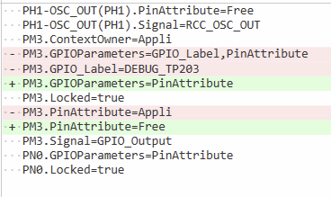

In my project for an STM32H7S3, I have a number of GPIO settings.
However, every time I open the file, one particular pin has its settings reverted to the defaults.
Also, if I save the IOC file without making any changes at all, I can see in the diff that the settings for that pin have been removed:
I'm currently using Cube 6.15.0, though this file was created with an earlier version.
I'm not willing to share my IOC file here, though I'd be happy to send it privately to someone at ST.
(See also another post by me about settings being lost without any action on my part.)
Thank you.

Hello @Steve Melnikoff ,
Do you have the same behavior with other MCUs (or only when selecting STM32H7S3)?
Please share in private your ioc file that will help us to reproduce the issue.
I'm afraid I haven't tried it with any other MCUs.
I've sent it to @Ghofrane GSOURI . Would you be able to get it from them?
I am not able to reproduce the described behavior.
Do you have the same issue with different MCUs?

Hello.
I have not tried it with any other MCUs.
Can you confirm that you have:
  1. Loaded the IOC file I supplied in CubeMX 6.15.0 or later.
  2. Immediately saved the file (if necessary, after making and undoing a change in order to force a save).
  3. Compared the original and current IOC files.
