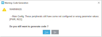

STM32CubeMX version: 6.10.0
STM32CubeU5 Firmware Package V1.4.0 / 20-October-2023
When I attempt to validate my X-CUBE-AI model on target, I receive the following pop-up:
Exploring STM32CubeMX.log shows the following warning:
[WARN] IP:2119 - SRAM6PowerDownInRunMode not found: check if there is a RefParameter without a condition.
The U5A5 doesn't even have an SRAM6, if I am reading the datasheet correctly.  When I look at the configuration options in CubeMX, I can't see anything for SRAM6 in the PWR section.

Please see attached files.  When I try to upload my .ioc file, I receive the following error:
The attachment's nucleo-u5a5zj-q.ioc content type (application/octet-stream) does not match its file extension and has been removed.
To get around this, I simply renamed it as the .txt file below.
I should also note that if I ignore the code generation error and proceed, validation on target executes successfully.

Hello @EdgyAI ,
This issue is fixed in the latest release of STM32CubeMx v6.15.
Thank you for your contribution.
