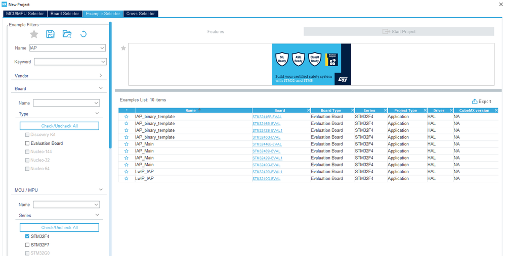

STM32F4x7 in-application programming (IAP) over Ethernet based on LwIP TCP/IP stack (AN3968), it is possible to realize this with stm32cubemx. Maybe there are manuals like this done through STM32CubeMX?

Unfortunately there is not an Application Note detailing how to create an "STM32F4x7 IAP over Ethernet based on LwIP TCP/IP" project using STM32CubeMX, but "STM32Cube Ethernet IAP example" User Manual may helps you: https://www.st.com/resource/en/user_manual/dm00103145-stm32cube-ethernet-iap-example-stmicroelectronics.pdf.
You can also find multiple examples in New project window - Example selector, that allows to start a new project from a selected example.

Yes, I know this example, this example does not have an ioc configuration file. The problem is that there is a project with an ioc file and a working device, I need to make it have the ability to update via the web interface (for example: routers). Judging by this documentation https://www.st.com/resource/en/user_manual/dm00103145-stm32cube-ethernet-iap-example-stmicroelectronics.pdf such an option is available, I will try to look.
