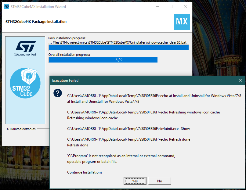

I have been trying to install STM32CubeMX (SetupSTM32CubeMX-6.9.1-Win.exe) for a *while* and yes I right-clicked and chose "Run as Administrator". It always fails during step 8/9 with the same message that "'C:\Program' is not recognized as an internal or external command, operable program or batch file." which is something anyone who has written many scripts or installers has overcome a couple times before not making that mistake again (or at least very often).
If I choose "No" here, I can then get to the error details window:

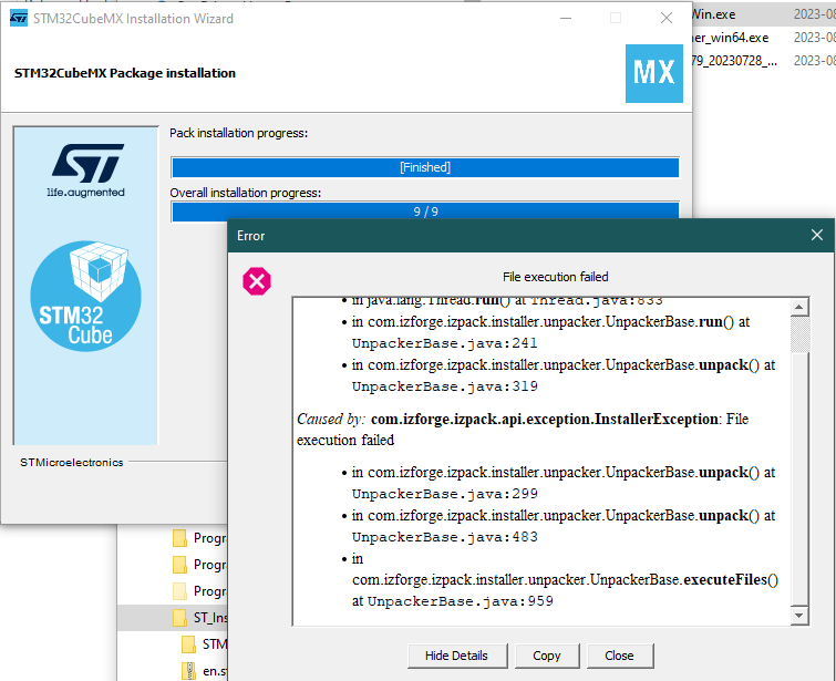

The full text from this window is :
com.izforge.izpack.api.exception.IzPackException: An error occured
in java.lang.Thread.run() at Thread.java:833
in com.izforge.izpack.installer.unpacker.UnpackerBase.run() at UnpackerBase.java:241
in com.izforge.izpack.installer.unpacker.UnpackerBase.unpack() at UnpackerBase.java:319
Caused by: com.izforge.izpack.api.exception.InstallerException: File execution failed
in com.izforge.izpack.installer.unpacker.UnpackerBase.unpack() at UnpackerBase.java:299
in com.izforge.izpack.installer.unpacker.UnpackerBase.unpack() at UnpackerBase.java:483
in com.izforge.izpack.installer.unpacker.UnpackerBase.executeFiles() at UnpackerBase.java:959

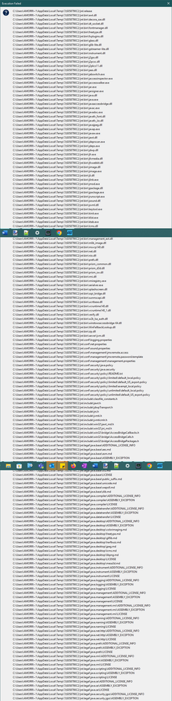

Now if I say "Yes" to the first error, then I get a new error window that even when I tried to make my screen extra tall by virtually stacking each window on top the other of my three screens, I still cannot see the bottom:

I ended up pulling essential data from my HD and starting from a completely fresh slate. In watching what happened, I noticed that in the first go around, I had all my install files in the C:\ST folder thinking this could never be a target for anything actually installed. I was wrong. To make matters worse, I was told by a coworker that maybe I should force the installs to go to the C:\ST folder. So I copied my C:\ST folder to a new folder C:\ST_Inst and then ran the install again forcing them to target C:\ST based on that recommendation. That turned out to be a very bad idea too. I had found related message to the error code "com.izforge.izpack.installer.unpacker.UnpackerBase.executeFiles() at UnpackerBase.java:959" but that was pointing to the installed version of java. However, the EXE for MX is a compressed file that 7-zip showed to have its own copy or a JRE folder, so all the time to enforce a particular java for all users was also a waste of time.

Seems like the installer doesn't understand spaces in the path.
Poor QA, and repetitive class of failure.
