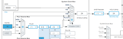

I'm new to ST platform and I would like to understand about clock configuration.
I'm using NUCLEOU545REQ board for my development and want to know how to enable HSI16 clock and configure system clock to 24Mhz using stm32cube
GUI.
Create a new project, use the Board Selector to select your board.
Go to the Clock Configuration tab, select HSI for the PLL source, and PLLCLK for the SYSCLK source. Type "24" in the HCLK box and press enter.

@TDK Thank you for your help. So once I enter 24 in HCLK other fields are getting updated which are in dropdown box.
Could you please share if there is any doc/resource available if I want to do manually configuration I mean in register level how do I calculate values for PLL - M,PLL - N,PLL- R ,PLL - Q
The register level details of how the chip operates are found in the Reference Manual.
