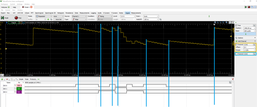

I am trying to create a lock-step synchronization between a timer that updates GPIO and a dac.
As you can see from the below, the GPIO leads the DAC transitions by 1 cycle, and that's not what I want:
My setup is as follows.
TIM8 generates a TRGO that drives the DAC1 DMA.
I also have a TIM8_UP DMA Request created through the DMA System Configuration.
The problem is that the TIM8_UP and TIM8_TRGO events are not synchronous, and differ by one cycle.
FYI I am using a Nucleo STM32G431KB.
I was trying to use the DMA Request Synchronization Settings to ensure the two different signals (DMA and GPIO) are exactly synchronous, but I cannot get it to work.
How could I do this through STM32CubeIDE?
I also noticed that there is no TIM8_TRGO DMA Request signal available. The datasheets are pretty difficult to search on this topic also and provide no additional clues that I could find.

Consider using a different event such as TIM8_CC1 instead of TIM8_UP where you can set the CCRx value to change the relative timing.
etheory
Senior II
Thanks @TDK​, I appreciate the suggestion, but I don't want to change the relative timing, I just want a lock-step signal with the DAC DMA, and I don't seem to be able to do that, since I can't seem to define DMA synchronization to ensure synchronous transfer.
If they’re one cycle off, you can adjust CCRx by one to get them in lock step. That would achieve what you want, as far as I can see.
