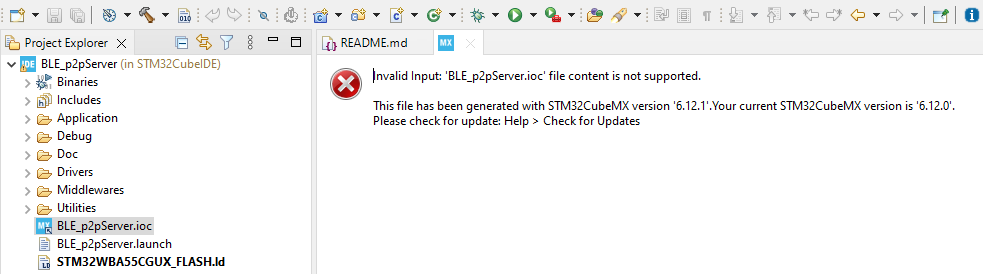

i want to import BLE_p2pServer example in CubeIDE 1.16.0 i got the message "This file has been generated with STM32CubeMX version '6.12.1'.Your current STM32CubeMX version is '6.12.0'."

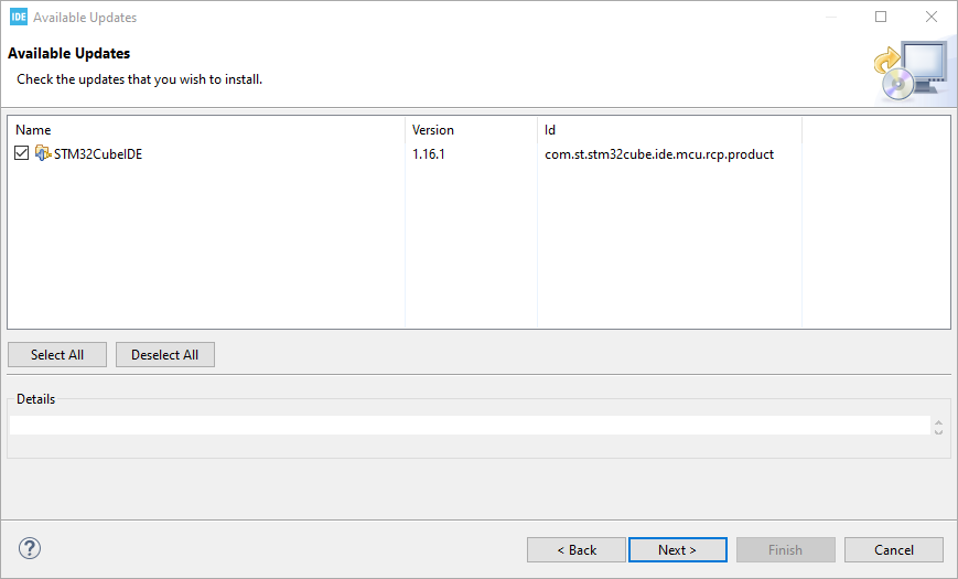

When i check for Updates, then I only have the option of updating CubeIDE itself to V1.16.1. How can I update CubeMx to V6.12.1 without updating CubeIDE? I think CubeMx is part of CubeIDE or do I have to install cubeMx separately?

CubeMX 6.12.1 is integrated in CubeIDE 6.12.1 so just update the CubeIDE and you will be able to work with your IOC generated with CubeMX 6.12.1

I think you mean CubeMX 6.12.1 is integrated in CubeIDE 1.16.1 and not in CubeIDE 6.12.1, right?

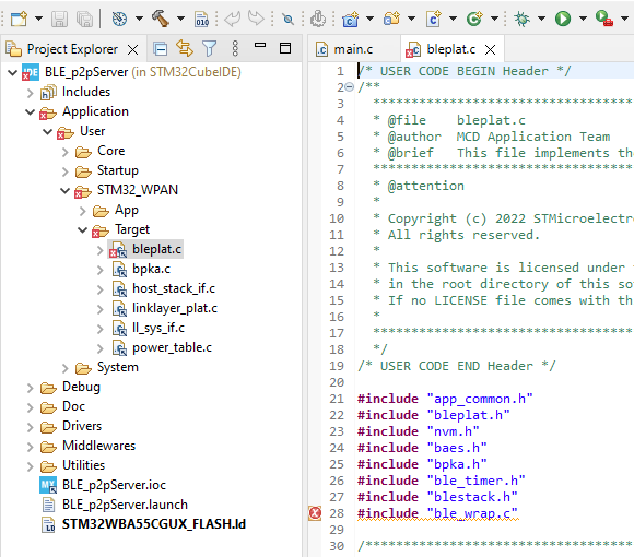

Ok, i did the update to CubeIDE 1.16.1, and first it seams to work, but unfortunately i got some erros after compiling.
Then i cleaned up the project, but the errors remained (it seems that ble_wrap.c is not found:
C:/Users/Admin/STM32CubeIDE/workspace_1.16.0/BLE_p2pServer/STM32_WPAN/Target/bleplat.c:28:10: fatal error: ble_wrap.c: No such file or directory
28 | #include "ble_wrap.c"
compilation terminated.
make: *** [Application/User/STM32_WPAN/Target/subdir.mk:34: Application/User/STM32_WPAN/Target/bleplat.o] Error 1
make: *** Waiting for unfinished jobs....
"make -j8 all" terminated with exit code 2. Build might be incomplete.
16:23:03 Build Failed. 3 errors, 0 warnings. (took 7s.789ms)

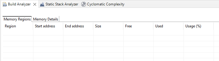

And what I also noticed is that nothing is displayed in the Build Analyzer window...
Hello @ledi001
I was able to reproduce the issue , I will check this internally and get back to you asap.
For the moment as a workaround add this file ble_wrap.c you can find it under this path \STM32Cube\Repository\STM32Cube_FW_WBA_V1.4.1\Middlewares\ST\STM32_WPAN\ble\stack\include\auto  to your project then rebuild

@ledi001 wrote:
@Ghofrane GSOURI
If you can't get the project to build without errors, clicking on the refresh button icon won't update any info.
