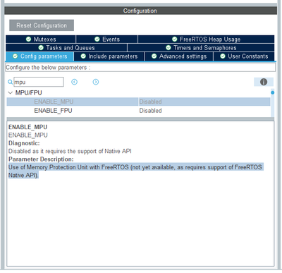

我正在使用STM32L431RCT6,我的 HAL 版本是最后一个。我想使用 FreeRTOS 的最后一个 API 让我的项目更稳定:
BaseType_t xTaskGenericNotify( TaskHandle_t xTaskToNotify, uint32_t ulValue, eNotifyAction eAction, uint32_t *pulPreviousNotificationValue ) PRIVILEGED_FUNCTION; #define xTaskNotify( xTaskToNotify, ulValue, eAction ) xTaskGenericNotify( ( xTaskToNotify ), ( ulValue ), ( eAction ), NULL ) #define xTaskNotifyAndQuery( xTaskToNotify, ulValue, eAction, pulPreviousNotifyValue ) xTaskGenericNotify( ( xTaskToNotify ), ( ulValue ), ( eAction ), ( pulPreviousNotifyValue ) )
但是我无法设置 ENABLE_MPU==Enabled,我不知道为什么:

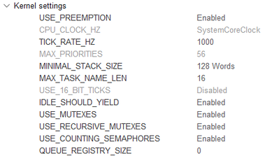

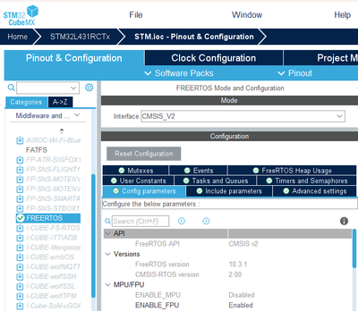

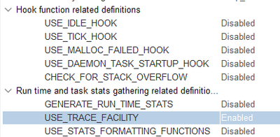

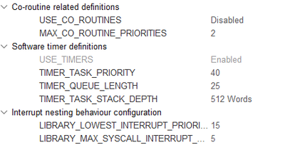

我的另一个配置是:
Wshuo1_1-1728564960228.pngWshuo1_2-1728564976868.pngWshuo1_3-1728564986038.pngWshuo1_4-1728564996489.pngWshuo1_5-1728565014455.png
我需要设置哪些选项才能启用此选项?

After clicking on the Enable_MPU message you can see the following message "Use of Memory Protection Unit with FreeRTOS (not yet available, as requires support of FreeRTOS Native API)."

Hello @Wshuo.1
I have already submitted a request to add support for the FreeRTOS memory protection unit MPU in CubeMX, as another user previously requested here
So the internal ticket (Ticket 190405) is still under investigation and I will keep you updated.
