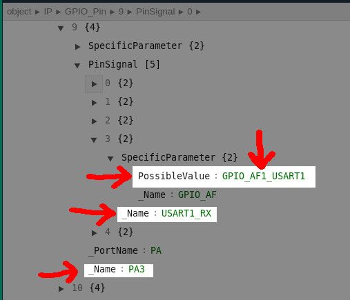

I'm using CubeMX's XML files as "Datasheets in database format" in my own "RTOS Hardware Configuration Tool". However, I couldn't find out how to extract the "Alternate Function Mapping" from those XML files:
The `mcu/config/llConfig/ADC-STM32F0xx_DefMapping.xml` is promising but I still couldn't figure out how to translate - eg. - `GPIO_AF2_TIM5` to anything.

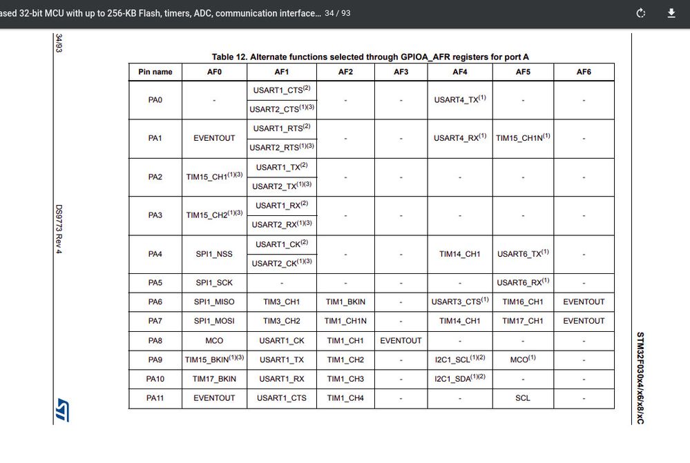

For example, in order to configure STM32F030F4Px's PA3 as USART1_RX, I need to set the relevant Alternate Function nibble to "1", as stated in datasheet.
What I could get from mcu/config/llConfig/GPIO-STM32F0xx_DefMapping.xml is that there are 3 "Item"s containing search word "usart1":
* An item contains "GPIO_AF0_USART1" string
* An item contains "GPIO_AF1_USART1" string
* An item contains "GPIO_AF7_USART1" string
How would I know which Item to parse?
In the file mcu/IP/GPIO-STM32F031_gpio_v1_0_Modes.xml, there is a structured data at: IP.GPIO_Pin.9 indicating the following:
This allows me to conclude that I need to set AF1 in order to configure PA3 as USART1_RX. However, this information is inside a file named *STM32F031*.xml where I'm interested in STM32F030F4Px.
How can I know which "*Modes.xml" file applies to STM32F030F4Px?
Does the following information indicate that I need to refer to GPIO-STM32F031_gpio_v1_0_Modes.xml for STM32F030F4Px:
mcu/STM32F030F4Px.xml: <IP ConfigFile="GPIO-STM32F0xx" InstanceName="GPIO" Name="GPIO" Version="STM32F031_gpio_v1_0"/>

STM32F031_gpio_v1_0_Modes.xml is a dead end (or I couldn't figure out how to interpret it). Can you use that file to obtain AF mappings?

Now, if you want to want to know the AF mapping for e.g. USART1_CTS, you just look at the PinSignal entry for that, find the GPIO_AF1_USART2 there, and extract the "AF2" part.
        <PinSignal Name="USART2_CTS">
            <SpecificParameter Name="GPIO_AF">
                <PossibleValue>GPIO_AF1_USART2</PossibleValue>
            </SpecificParameter>
        </PinSignal>
It seems you still need the second file, since that defines which signals are available exactly on this pin on this chip, while the second file defines a lot more signals, probably the union of available signals on this chip for all chips from this particular family.
Does that help?
(note that I'm not at all sure that what I'm saying is the best or even a fully correct way of approaching this, but from looking at the XML files, I think this would make sense)
