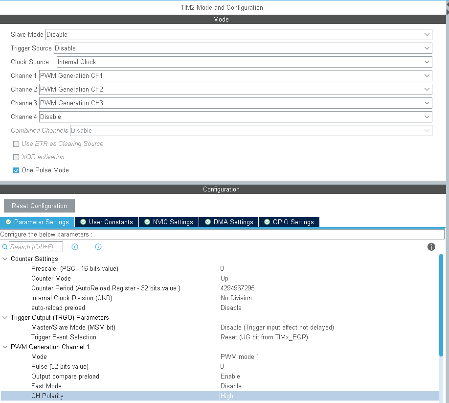

I am trying to output One Pulse Mode, however the output is not back to 0V when the pulse is complete. The One Pulse is started with a button interrupt.
The timing of the One Pulse is correct, but when the pulse is finished, the output was set to high. And this created another problem, the button would not trigger One Pulse again.

  htim2.Instance = TIM2;
  htim2.Init.Prescaler = 0;
  htim2.Init.CounterMode = TIM_COUNTERMODE_UP;
  htim2.Init.Period = 4294967295;
  htim2.Init.ClockDivision = TIM_CLOCKDIVISION_DIV1;
  htim2.Init.AutoReloadPreload = TIM_AUTORELOAD_PRELOAD_DISABLE;
  if (HAL_TIM_Base_Init(&htim2) != HAL_OK)
    Error_Handler();
  sClockSourceConfig.ClockSource = TIM_CLOCKSOURCE_INTERNAL;
  if (HAL_TIM_ConfigClockSource(&htim2, &sClockSourceConfig) != HAL_OK)
    Error_Handler();
  if (HAL_TIM_PWM_Init(&htim2) != HAL_OK)
    Error_Handler();
  if (HAL_TIM_OnePulse_Init(&htim2, TIM_OPMODE_SINGLE) != HAL_OK)
    Error_Handler();
  sMasterConfig.MasterOutputTrigger = TIM_TRGO_RESET;
  sMasterConfig.MasterSlaveMode = TIM_MASTERSLAVEMODE_DISABLE;
  if (HAL_TIMEx_MasterConfigSynchronization(&htim2, &sMasterConfig) != HAL_OK)
    Error_Handler();
  sConfigOC.OCMode = TIM_OCMODE_PWM1;
  sConfigOC.Pulse = 0;
  sConfigOC.OCPolarity = TIM_OCPOLARITY_HIGH;
  sConfigOC.OCFastMode = TIM_OCFAST_DISABLE;
  if (HAL_TIM_PWM_ConfigChannel(&htim2, &sConfigOC, TIM_CHANNEL_1) != HAL_OK)
    Error_Handler();
  if (HAL_TIM_PWM_ConfigChannel(&htim2, &sConfigOC, TIM_CHANNEL_2) != HAL_OK)
    Error_Handler();
  if (HAL_TIM_PWM_ConfigChannel(&htim2, &sConfigOC, TIM_CHANNEL_3) != HAL_OK)
    Error_Handler();
  /* USER CODE BEGIN TIM2_Init 2 */
  __HAL_TIM_SET_PRESCALER(&htim2, Master_Prescale);
  __HAL_TIM_SET_AUTORELOAD(&htim2, Master_Arr);
  __HAL_TIM_SET_COMPARE(&htim2, TIM_CHANNEL_1, Master_PulseOff);
	//TIM_CCxChannelCmd(htim2.Instance, TIM_CHANNEL_1, TIM_CCx_ENABLE);
	//__HAL_TIM_CLEAR_IT(&htim2, TIM_IT_UPDATE);
	//__HAL_TIM_ENABLE_IT(&htim2, TIM_IT_UPDATE);
  /* USER CODE END TIM2_Init 2 */
  HAL_TIM_MspPostInit(&htim2);

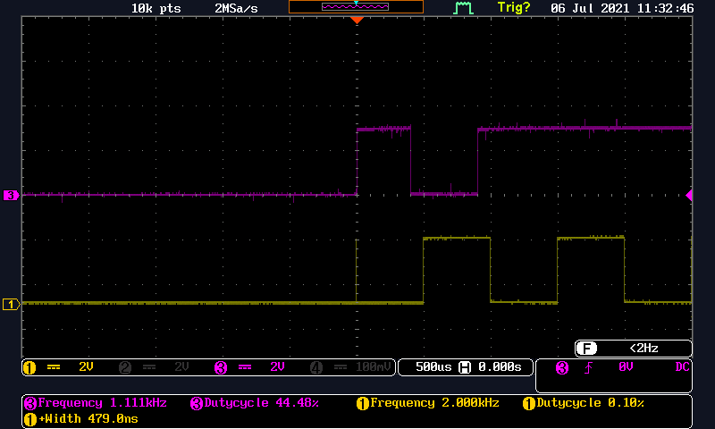

Purple line (Timer 2)= the One Pulse output. Yellow line (Timer 1) = Mode 2 PWM 1Khz 50% duty cycle, started simultaneously with the One Pulse timer

I have just updated the codes following your suggestion, but the problem still persist i.e. the purple line still remains high after One Pulse.

To ensure it's not problem caused by the shadow register, I commented all of my user code in Tim2 init, and set correct numerical values inside CubeMX. However , it still didnt solve the issue.
