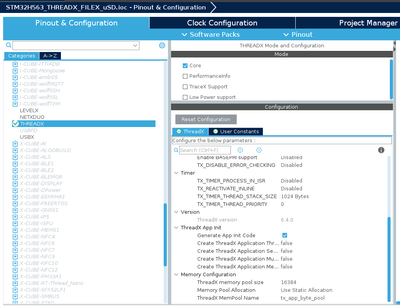

In CubeMX I enabled ThreadX and FileX with the default configuration, increased ThreadX "memory pool size" to 2k and  enabled "Generate Init Code" for both.
In app_azure_rtos.ctx_application_define() function MX_FileX_Init() fails - tx_byte_allocate() returns error code 16. According to docs that means TX_NO_MEMORY "Service was unable to allocate a block of memory within the specified time to wait.".
I get this error even when I substantially increase ThreadX "memory pool size" to 64k.

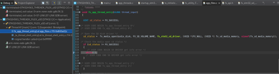

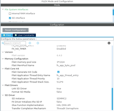

Initially, operating files in SRAM via fx_media_open only worked after increasing the default value of FX_APP_THREAD_STACK_SIZE from 512B to 4 × 512B.
Subsequently, we switched to operations with a 16 GB SD card, maintaining the same parameters. However, the fx_media_open command fails to open the media, returning FX_BOOT_ERROR (0x01).

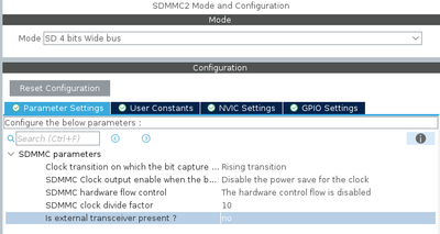

2. The SDMMC clock was reduced to 25 MHz.

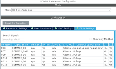

Attached are some screenshots of CubeIDE/MX for reference.
