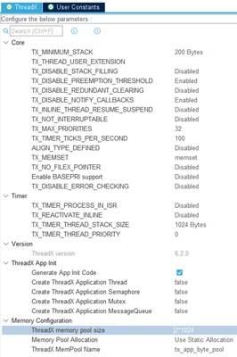

In CubeMX I enabled ThreadX and FileX with the default configuration, increased ThreadX "memory pool size" to 2k and  enabled "Generate Init Code" for both.
In app_azure_rtos.ctx_application_define() function MX_FileX_Init() fails - tx_byte_allocate() returns error code 16. According to docs that means TX_NO_MEMORY "Service was unable to allocate a block of memory within the specified time to wait.".
I get this error even when I substantially increase ThreadX "memory pool size" to 64k.
Without FileX enabled ThreadX works - I created a timer which nicely blinks the onboard LED.

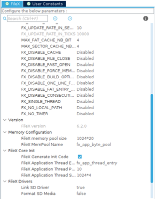

i use FileX on sd-card (because forced by STM to use it, no more fatFS ... grrr )
and have exfat enabled, which is used on most >32GB cards.
Here my (working :) ) setting:
btw
also ThreadX delay-tick is set to 1ms , to have same delays as in HAL without much thinking or conversion.

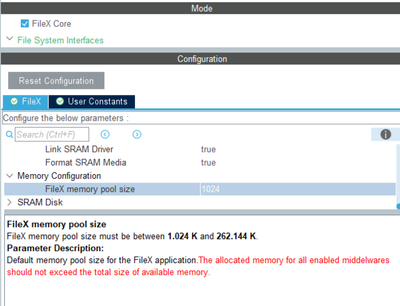

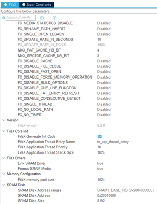

     I installed CubeMX 6.11.1. Still fails  MX_FileX_Init() fails - tx_byte_allocate(). Have you verified the latest CubeMX and check if FileX and ThreadX can be working together? Thanks in advance.
FBL
Hi @Victorheca01
Do you mean you still have an issue of memory pool size? Same error TX_NO_MEMORY ?  or section placement failed ? If so, MX team suggests implementing a warning message as workaround to prevent surpassing the available total memory size AzureRTOS (+threadX ..). Nonetheless, should you encounter any problems with the thread stack size exceeding the memory pool size, please feel free to report back.
