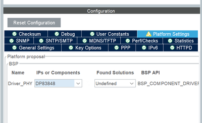

How to Configure a Custom PHY Address inSTM32cube IDE 1.14.1?
priyazcs
I'm using an STM32F427 and no RTOS, along with a custom PHY. However, I’ve encountered issues configuring a custom PHY address in STM32CubeIDE 1.14.1:
  1. Custom PHY Address Setup
    My setup requires a specific PHY address, such as 0x80, but STM32CubeIDE 1.14.1 only lists options for LAN8742 and DP83848. Selecting "Undefined PHY" triggers a warning, which limits proper configuration. In STM32CubeIDE 1.8.0, I was able to configure a custom PHY without any issues.
Could you please provide guidance on how to set up and configure a custom PHY in version 1.14.1? Any information on handling this in the latest versions to avoid warnings and allow for custom PHY addresses would be greatly appreciated.
Thank you.

Hello @priyazcs
Steps to Configure a Custom PHY in STM32CubeIDE 1.14.1
Select Undefined PHY
In the STM32CubeIDE, when configuring the Ethernet settings, select "Undefined PHY". This will allow you to bypass the default options for LAN8742 and DP83848.GhofraneGSOURI_0-1730724710228.png
Modify the Generated Code
  • After generating the project code, navigate to the ethernetif.c file located in your project directory .
  • You will need to manually implement the initialization and configuration for your custom PHY. This may involve:
    • Setting up the correct PHY address (e.g. 0x80).
    • Configuring any specific registers required by your custom Phy.
Create a Custom PHY Driver
  • If you haven't already, create a custom driver for your PHY based on existing drivers (like those for LAN8742 or DP83848). You can use them as templates.
  • Implement necessary functions such as:PHY_Init()
    PHY_Read()
    PHY_Write()
Handle Warnings:
  • The warning triggered by selecting "Undefined PHY" can be ignored if you ensure that your custom driver is correctly implemented and integrated into the Ethernet stack Update
Initialization Functions:
  • Ensure that any initialization functions related to Ethernet (like HAL_ETH_MspInit) are correctly implemented to call your custom PHY initialization function.
Please check this POST , it could help you .
THX
Ghofrane
Hi Ghofrane,
Thankyou for your response.After configuring a custom PHY in STM32CubeIDE 1.14.1, I successfully managed to ping the MCU. However, I am encountering issues where UDP packets are not being sent.
Steps Taken:
  1. Custom PHY Selection: I set "Undefined PHY" in the platform settings and generated the code.
  2. Code Modifications in ethernetif.c:
    • Added HAL_ETH_
