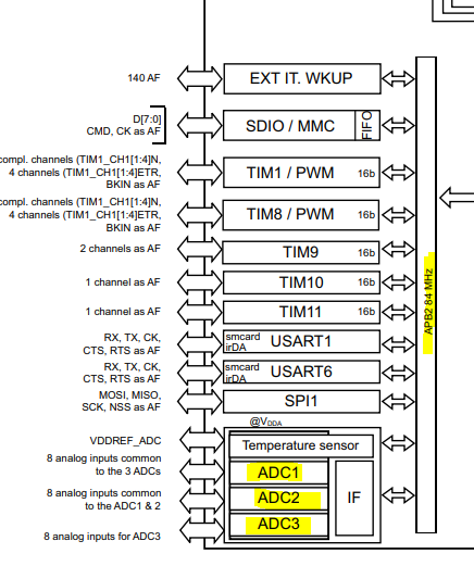

  1. In determining the ADC clock i am bit confused, i am using STM32F4 so according to data sheet below the APB2 clock for ADC is 84Mhz, and i am using prescaler 2, so does the ADC clock will be 42Mhz in my case?0693W00000GXjyzQAD.png
