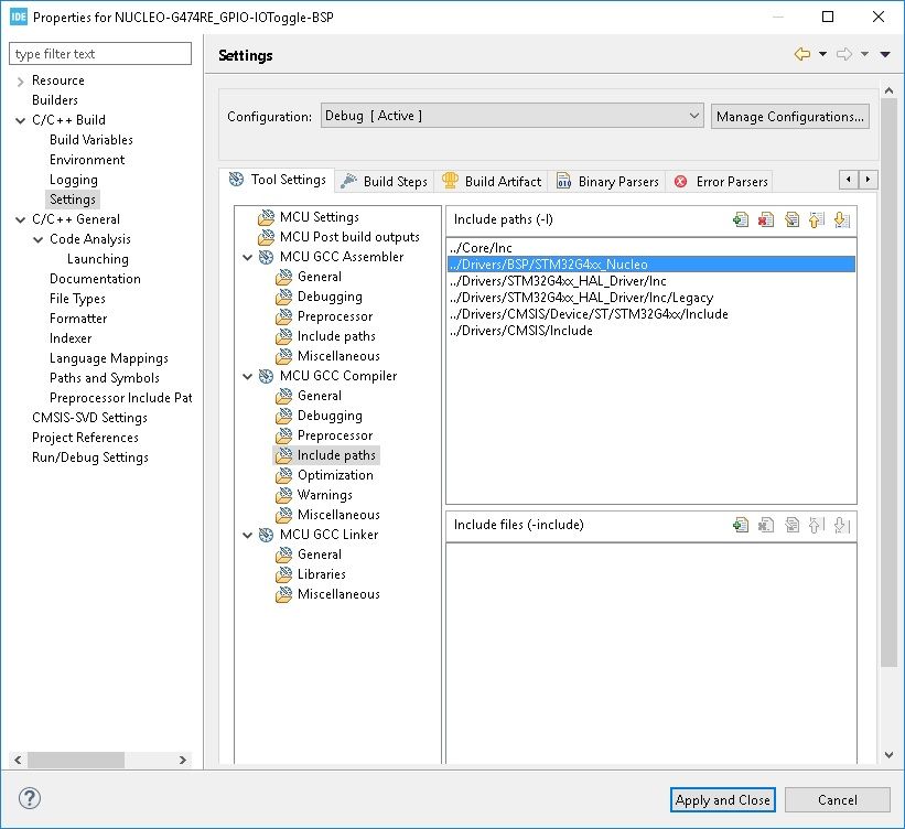

Hi, I try to use stm32f429 lcd screen. for this i need to add bsp library in my project and then use some .c file like sdram.c lcd.c etc.
Can someone explain how can i add this library ?

I think you could follow the attachment to deal with "adding BSP into your CubeIDE project" in a quick way so you could start from a BSP added code base.

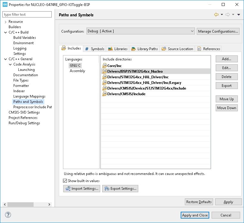

I followed Ethan HUANG's answer. It fixed almost all of the undefined references, but createFramewin() (in GUI_App.c) is still undefined.
victagayun
Senior III
0693W000003OgEoQAK.jpgYou may still need to add it in the GCC compiler include path
and check if added in path and symbols
