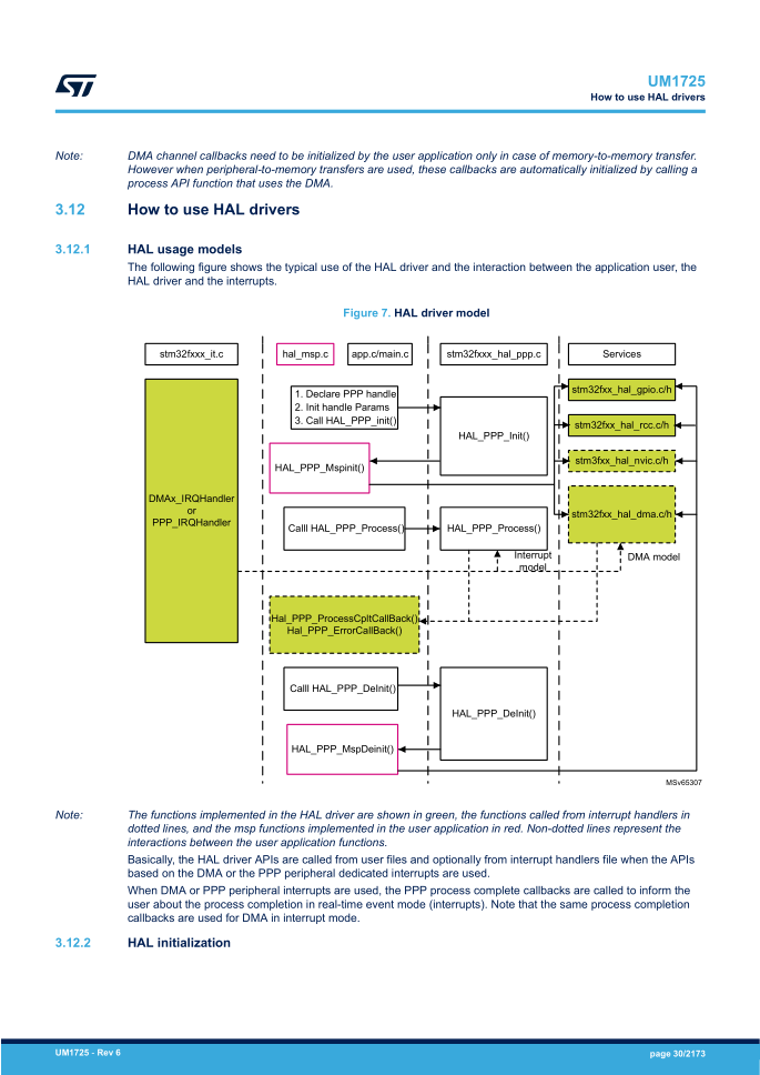

However, I cannot find any generated code which links the Timer Output Channel 1 to my GPIO Pin PA5. Is it being saved somewhere else, or is it being saved in some obscure way that I've missed?

Normally, this "assignment" is through setting value corresponding to given peripheral (see table in Datasheet) into the field appropriate for given pin in respective GPIOx_AFR register (see GPIO chapter in RM).
So, this is GPIO-setup related.
I don't Cube, but AFAIK they like to put these things into a "MSP" callback, to be called from the timer initialization function, probably in a separate .c file (stm32XXXxx_hal_msp.c ?)

Excellent. You were correct, it is set up in stm32f4xx_hal_msp.c
I find it a little odd that most of the user defined setup is in main.c, and some bits in the _hal_msp file.
