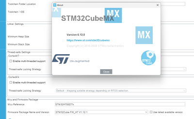

Hi, @Amel NASRI

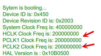

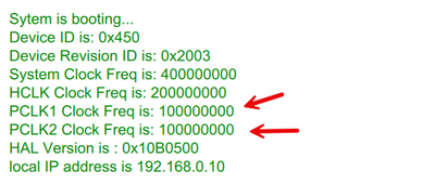

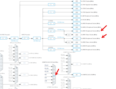

By the way, RCC clock auto configuration is also wrong.
but result showing:
which will mess up UART baud rate ( I have to chage UART clock source to HSI to get correct UART output, the old is PCLK1), same issue as the post you linked.
CubeMX 6.13.0 and MCU Package H7 v1.12.0 produce i... - STMicroelectronics Community
These issues are fundamental, need to be resloved with high priority.
