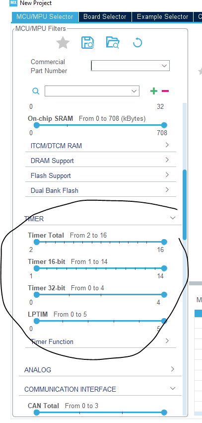

I have a project where I need at least 8 PWM input channels, 10 would be great.
I can't see a method to filter by PWM input on the website or in STM32CubeMX. I would like to round it down to a few devices and compare them on cost, package, etc.
Is there a method to do this that I'm missing?
At the moment I'm simply choosing the devices with the most timers and working through the list 1 by 1 using STM32CubeMX, this is quite a slow approach.
Any advice is welcome.
Thanks
Javier1
Principal
Search fot number of TIMers,
0693W00000YAsqqQAD.pngSo it would boil down to series F1 F4 and F7

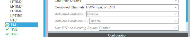

Javier,
Yes, I'm using the "Combined Channels" feature which allows the channel 1 input capture to measure the signal period and channel 2 to measure the pulse width (on time). This has worked well in combination with DMA.
0693W00000YAsmMQAT.pngI will look into the ADC suggestion :)
STM32F7 value line is the best match so far, but it would be useful if the search function in STM32CubeMX or the ST website allowed filtering by which timers support PWM input capture
KnarfB
9 PWM input timers on STM32H723ZGTx, who finds more?

KnarfB,
Nice find, I just checked the STM32H723 device and it has 10 PWM inputs, 9 of which have DMA.

waclawek.jan
Depending on particularities of input signal, you should be able to get away without the timer reset, purely from input capture on the CH1/CH2 and CH3/CH4 pairs, doubling the capability of the "usual" 4-channel timers. If edges are sufficiently far apart, a single channel should suffice per signal, allowing you to use almost any STM32 with enough pins.
