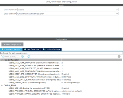

Hi guys,
I'm trying to use STM32 as a host for a HID keyboard and mouse.
I have 2 wireless mouses to test (Logitech M560, HP Spectre 700), Logitech T-BC21 wired trackball, some low-end keyboard. I'm connecting them via micro-USB to USB converter that works properly with my old tablet.
LED near USB port on NUCLEO lights up, looks like it enumerates my all test devices (function returns OK), but I'm always getting stuck in USBH_HID_POLL state and I never get this condition true (after pressing keys, moving or clicking mouses):
// usbh_hid.c USBH_HID_Process(...) function
if (USBH_LL_GetURBState(phost, HID_Handle->InPipe) == USBH_URB_DONE)
I'm following this tutorial from ControllersTech, that basically just uses generated code, except that I'm using FreeRTOS. USB interrupt is enabled (can't be turned off in code generator).
I'm powering NUCLEO from my PC USB port (programming/debugging). I have not tried to power the board from external 5V supply, but I don't think this could make any difference, since the keyboard is relatively low power.
My environment:
STM32CubeIDE
Version: 1.13.2
Build: 18220_20230914_1601 (UTC)

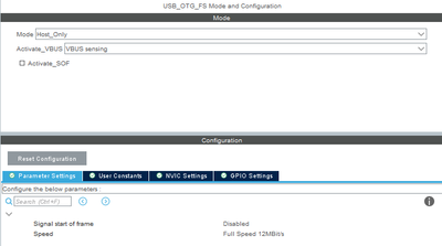

Here is my configuration:

I have found a solution.
The problem was in 1.17 software package.
I have crated two identical projects:
  • FW 1.16.2 (CubeIDE  1.9.0) - this is working
  • FW 1.17 (CubeIDE 1.13.2 - most recent at this time) - this is not working
It looks like new driver or middleware is somehow broken.
The problem is blooming on github for few months (link), looks like it affects various USB demo applications for Discovery and Nucleo devices (confirmed by others on github) and also generated middleware or driver code in my case.
Thanks for your interest guys, I hope the staff will find time to look into it. So far, the most reasonable solution is to use an older version of the IDE with an older firmware package (the new version of the IDE does not support FW 1.16.2).

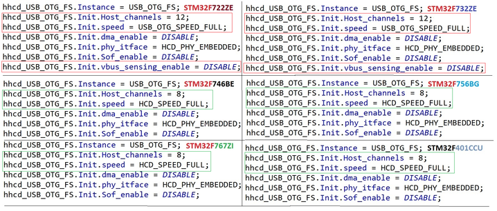

hi ..
any solution  on ticket number  for usb issue ? . i  am having similar issue like below
https://community.st.com/t5/stm32-mcus-products/serious-bug-in-usb-keyboard-stm32f722ze-nucleo-board/m-p/667122#M242306
problem is very much visible
Speed setting different  & channels number is different :
Cube ide Generating additional code line  for STMF722ZE & STM32F732ZE ( complete STMF72XXXXX series STMF73XXXX )
additional code line:
Cube ide Generating code without additional above mentioned line  for STMF746XX,STM32F756XX &STM32F767XX & STM32F401XXXXseries .
code generation must be only issue .
