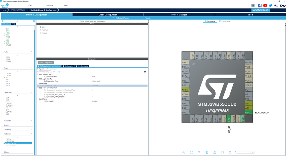

Hi, I am using STM32WB55 custom board,
AM.12
I have to configure it as a Client. Can please someone help me with the starting guide for the client configuration like how to establish connection with server and how to write attribute to server, everywhere I found only starting guide for server only.

To configure the STM32WB55 as a BLE client using the CubeMX software, you'll need to perform the following steps:
  1. First, you'll need to use the CubeMX tool to configure the necessary peripherals and generate the initial project for your STM32WB55 board. Make sure to enable the BLE module and configure it as a client.
  2. Next, you'll need to use the generated code to establish a connection with the server. You can do this by using the provided BLE stack to scan for available BLE devices and connect to the desired server device.
  3. Once connected, you can use the provided stack to write attributes to the server. Each attribute is represented by a unique handle, and you can use the stack's API to write the value of the attribute to the server.
  4. The stack will also provide a way to check the status of the connection and the current state of the device(client)
  5. In the end of your application use disconnect API provided by stack to disconnect the connection.
0693W00000Y7whmQAB.pngThe process for establishing a connection with a BLE server using a BLE wireless stack will depend on the specific stack you are using, but in general, you will need to perform the following steps:
