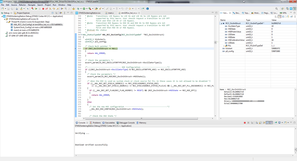

Called from SystemClock_Config.
The pointer is clearly ok, as you can see in the Vars window, but the check detects it as null and exits with HAL_ERROR.
Doesn't make any sense, any thoughts?

Which STM32?
Are you sure it's this check which returns with HAL_ERROR? Single-step in disasm window and observe what's happening in the registers.
Alternatively, switch optimization (maybe only for this particular function) off.
