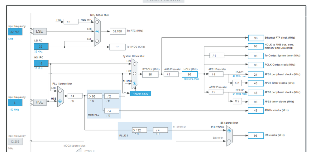

Using the STM32Cube with a STM32F4, I set the SYSCLK to 96Mhz
Which generates this code
 RCC_OscInitStruct.OscillatorType = RCC_OSCILLATORTYPE_HSE|RCC_OSCILLATORTYPE_LSE;
 RCC_OscInitStruct.HSEState = RCC_HSE_BYPASS;
 RCC_OscInitStruct.LSEState = RCC_LSE_ON;
 RCC_OscInitStruct.PLL.PLLSource = RCC_PLLSOURCE_HSE;
 RCC_OscInitStruct.PLL.PLLM = 4;
 RCC_OscInitStruct.PLL.PLLN = 96;
 RCC_OscInitStruct.PLL.PLLP = RCC_PLLP_DIV2;
 RCC_OscInitStruct.PLL.PLLQ = 4;
However, if I call HAL_RCC_GetSysClockFreq directly after SystemClock_Config() e.g.
 SystemClock_Config();
 clkF = HAL_RCC_GetSysClockFreq();
clkF is 72000000 i.e 72Mhz
I've checked that HSE_VALUE is correctly defined as 8000000
So I made a copy of HAL_RCC_GetSysClockFreq() and added some debugging, which produced these values
uint32_t pllm = RCC->PLLCFGR & RCC_PLLCFGR_PLLM;
uint32_t plln = (RCC->PLLCFGR & RCC_PLLCFGR_PLLN) >> RCC_PLLCFGR_PLLN_Pos;
uint32_t pllvco = ((int64_t)HSE_VALUE * (int64_t)plln / (int64_t)pllm);
uint32_t pllp = ((((RCC->PLLCFGR & RCC_PLLCFGR_PLLP) >> RCC_PLLCFGR_PLLP_Pos) + 1U) *2U);
uint32_t sysclockfreq = pllvco/pllp;
USB_DEBUG_printf("HSE:%d pllm:%d plln:%d pllvco:%d pllp:%d SYSCLK:%d\n",HSE_VALUE,pllm,plln,pllvco,pllp,sysclockfreq);
HSE:8000000 pllm:8 plln:288 pllvco:288000000 pllp:4 SYSCLK:72000000
So PLLM is being read from the hardware as a different value to what has been requested, and PLLN value is something totally different.
With the result that the SYSCLK is either wrong, or being wrongly calculated by HAL_RCC_GetSysClockFreq
I've looked at the frequency of some of the PWM outputs that I'm using, and it does appear that the processor is running at 72Mhz not 96Mhz
Yet the Timer 14 millisecond tick interrupt does seem to be the correct frequency
Hence I'm confused about whats going on :(

Just to potentially answer my own question.
I think the call to SystemClock_Config(); may be failing to initialise the clock because the main application is being run by proprietary bootloader, which has probably already setup the MCU with those configuation settings
Is there any way I can reset the RCC ready to have a new RCC config applied ?

I found sample code for a STM32G0 to switch clock inputs and I have modified the function that sets SYSCLK as LSI to use HSI (see below)
Calling this at the beginning of main() seems to resolve the problem of the HSE PLL config not being accepted.
And my debug code is now outputting the SYSCLK value I had expected
HSE:8000000 pllm:4 plln:96 pllvco:192000000 pllp:2 SYSCLK:96000000
So I have solved one mystery.
Perhaps by default the STMCube generated code should check if the SYCLK is already set to HSE before and set it to HSI, becuase I can't believe this is the only instance where people are using a bootloader which may not be using the same RCC OSC / PLL values as the main application.
