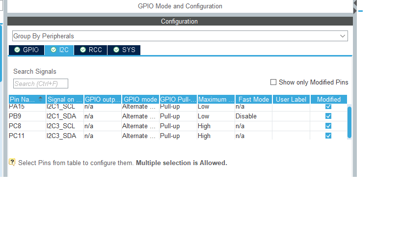

I use MAX9611 to measure current. It has 2 register to read current. 12 bits divides 2 bytes. MSB(8 bits) and LSB(4 bits). I tried to read only MSB but I couldn't, Can anyone help me?
 Note: there is no externall pull up res, I configure an internal pull up.
_legacyfs_online_stmicro_images_0693W00000dJpJhQAK.pngI write a simple code. HAL_I2C_IsDeviceReady return HAL_OK. But when I debug HAL_I2C_Mem_Read returns nothing

First of all thank you for your reply,
I wondered how could I check if line is idle and search for it. I saw it in a video and I implemented it. When I debug code, it returns HAL_OK every time. But I will check and make it in a proper way.
I check MAX9611's datasheet, to read data device adress 0XE1 and write adress is 0xE1 in my device's condition. MAX9611's A0 and A1 pins connected to GND.
For reading, first I send a data in int main, it is how it is written like this in datasheet.
And then in while(1)
isDeviceReay();
HAL_I2C_Mem_Write(&hi2c1, 0xE0, 0x02, 1, CurVal, 1, 100);
HAL_GPIO_WritePin(ENABLE_M_GPIO_Port, ENABLE_M_Pin, 1); // Enables mosfet
HAL_I2C_Mem_Read(&hi2c1, 0xE1, 0x02, 1, CurVal, 1, 100);
I observe load draws 500mA from powersupply when I open mosfet. But buffer is empty.
When I read temperature register(0x08) it turns 128. This is not possible either.
