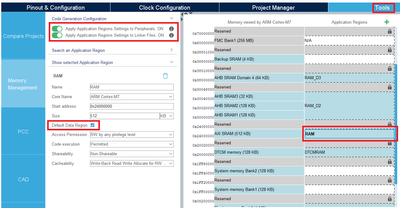

Since the latest release of CubeMX (6.12.1), I have been encountering syntax errors related to the "FLASH.ld" file. This issue only arises when I generate code while setting the Toolchain/IDE to CMake. I am using STM32H753IIKx. It seems that CubeMX does not specify which RAM to use when setting the Toolchain/IDE to CMake.
I have also included the FLASH.ld file that was generated for your reference.
Thanks for your help.

‎2024-12-03 1:58 AM - edited ‎2024-12-03 1:59 AM
Yes, it solves the problem for me now. I will mark it as a solution.
Even though the code can now be compiled without any error, when I flash the code on my MCU, it does not run since CubeMX chooses the DTCMRAM as the default RAM.
Is there any way to select which RAM to use in CubeMX, by any chance? Should I create another post to highlight this issue?
Thanks

‎2024-12-03 4:27 AM
Hard to say. In my case, DTCMRAM is not the right RAM for my application.
‎2024-12-03 6:00 AM - edited ‎2024-12-03 6:16 AM
I think I found a solution to also choose the desired RAM in CubeMX. This has been added in CubeMX v6.13.
To do this, navigate to Tools > Memory Management, where you can select the type of RAM you want to use.
Make sure to enable the following options:
- "Apply Application Regions to Peripherals"
- "Apply Application Regions to Linker Files"
- and check the "Default Data Region" box.
Also, ensure that you delete the existing .ld file in your project folder. Otherwise, the .ld file will not be updated.
I have highlighted the important steps for your attention in the figure below:
