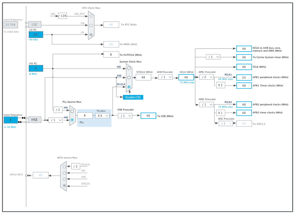

I'm trying to get a custom F405 board (open hardware from stm32duino) to run a simple HID example (https://notes.iopush.net/stm32-custom-usb-hid-step-by-step-2/). I got it running on an F103 and am trying to get it running on the F405, but it doesn't connect (neither when debugging via SWD, nor when not debugging and simply connecting the the PC).
From what I see, it remains in the "USBD_STATE_SUSPENDED" state.
Trying to figure out the differences, I noticed the Clock configuration screen between the F103 and F405 is different, and as such also the generated code.
which generates code like this:

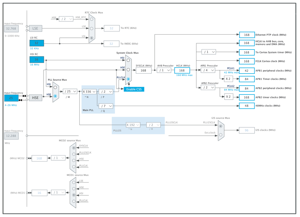

The F405 clock looks like this
​and the generated code looks like this:
void SystemClock_Config(void)
  __HAL_RCC_PWR_CLK_ENABLE();
  __HAL_PWR_VOLTAGESCALING_CONFIG(PWR_REGULATOR_VOLTAGE_SCALE1);
  /** Initializes the CPU, AHB and APB busses clocks
  RCC_OscInitStruct.OscillatorType = RCC_OSCILLATORTYPE_HSE;
  RCC_OscInitStruct.HSEState = RCC_HSE_ON;
  RCC_OscInitStruct.PLL.PLLSource = RCC_PLLSOURCE_HSE;
  RCC_OscInitStruct.PLL.PLLM = 25;
  RCC_OscInitStruct.PLL.PLLN = 336;
  RCC_OscInitStruct.PLL.PLLP = RCC_PLLP_DIV2;
  RCC_OscInitStruct.PLL.PLLQ = 7;
    Error_Handler();
  RCC_ClkInitStruct.APB1CLKDivider = RCC_HCLK_DIV4;
  RCC_ClkInitStruct.APB2CLKDivider = RCC_HCLK_DIV2;
  if (HAL_RCC_ClockConfig(&RCC_ClkInitStruct, FLASH_LATENCY_5) != HAL_OK)
    Error_Handler();
So where the F103 does something with a "peripheral usb clock" there is no such thing for the F405? There doesn't seem to be anything "usb" related in the F405 clock configuration screen... Does it use the "Main PLL -> 48 Mhz Clock (Mhz) (the one at the bottom)?

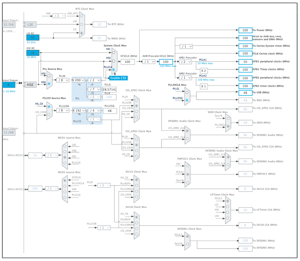

Looking at the MCU example pack for the F4, at an F413ZH (because it doesn't have samples for the F405), there's also some code to initialise Peripheral/USB, like this:
  /* Select PLLSAI output as USB clock source */
  PeriphClkInitStruct.PLLI2S.PLLI2SM = 8;
  PeriphClkInitStruct.PLLI2S.PLLI2SQ = 4;
  PeriphClkInitStruct.PLLI2S.PLLI2SN = 192;
  PeriphClkInitStruct.PeriphClockSelection = RCC_PERIPHCLK_CK48;
  PeriphClkInitStruct.Clk48ClockSelection = RCC_CK48CLKSOURCE_PLLI2SQ;
  HAL_RCCEx_PeriphCLKConfig(&PeriphClkInitStruct);

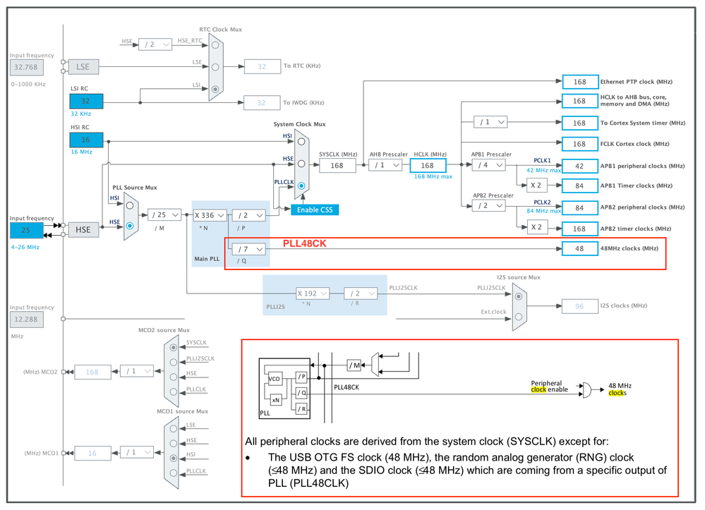

I still found this in the STM32F405xx manual: (2.2.31) "The USB OTG full-speed controller requires a dedicated 48 MHz clock that is generated by a PLL connected to the HSE oscillator. ".
So why isn't there anything like that generated for the F405? How do I get CubeIDE to generate such code for the F405? Or is it correct as-is ( I doubt it, but maybe...? )
2 REPLIES 2
RCC_OscInitStruct.PLL.PLLQ = 7; // 336 / 7 = 48 MHz Q tap is USB/SDIO/CRYPT clock on F405, see Clock Tree in Reference Manual
RBoer
Ah, I was looking at the Datasheet, instead of the Reference Manual.
So putting it all in 1 diagram, the Q line is the PLL48CK and is USB/SDIO/CRYPT on 48 Mhz ( it just shows "48Mhz Clocks" as there are multiple, instead of specifically mentioning "to USB" like it does for the F103 and "To USB / To RNG" for the F413 which additionally has a separate "To SDIO"). Since there is a direct connection from Q to "48Mhz Clocks" (i.e. nothing inbetween which needs configuring) it suffices to have initialization code for the "Main PLL"-block.
As for the F413, creating the clock configuration diagram from the sourcecode it looks like this:
... and here there is a "PLL48CK Mux" -block in which an input can be configured, so it makes sense the F413 has "extra" code for initializing that.
